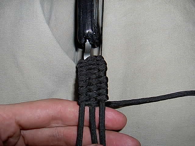

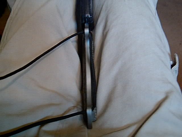

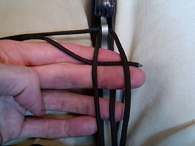

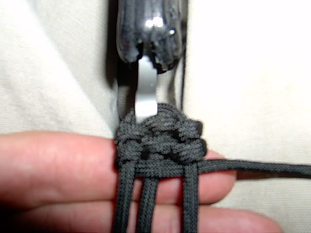

Aight... I'm going to attempt to explain how to do the guard in case anyone was wondering... If not, just consider this me entertaining myself
YOU ARE GOING TO NEED A BUSSE, WITH A REAR AND FRONT TALON HOLE. I USE 15 FEET (overkill but safer) OF 550 CORD. IF YOU HAVE ACCESS TO A VISE, THIS WILL MAKE IT EASIER FOR YOU. IF NOT, HOLD IT BETWEEN YOUR KNEES OR FEET (keep it mostly sheathed for safety of course).
THIS IS DONE EDGE UP BLADE FACE AWAY FROM YOU...
STEP 1: FEED APPROX. 12" OF 550 CORD THROUGH REAR TALON HOLE ENTERING ON THE RIGHT AND EXITING ON THE LEFT. YOU SHOULD HAVE 12" OF PARACORD STICKING OUT THE LEFT SIDE AND THE REMAINING AMOUNT ON THE RIGHT LIKE SO:

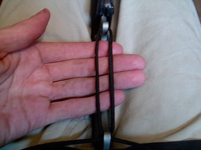

STEP 2: TAKE THE LONGER STRAND AND FEED IT THROUGH THE FRONT TALON, LEFT TO RIGHT AND PULL TIGHT. ADJUST IT TO YOUR LIKING ON HOW TIGHT YOU WANT YOUR D GUARD. LIKE SO:

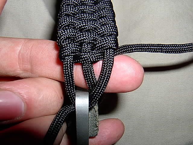

STEP 3: CONTINUE WITH THE LONG STRAND AND FEED IT, LEFT TO RIGHT THROUGH THE REAR TALON LIKE SO: (pull tight again to liking)

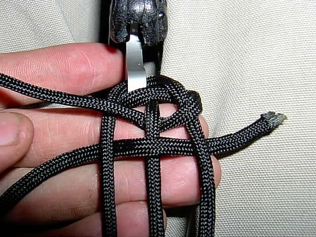

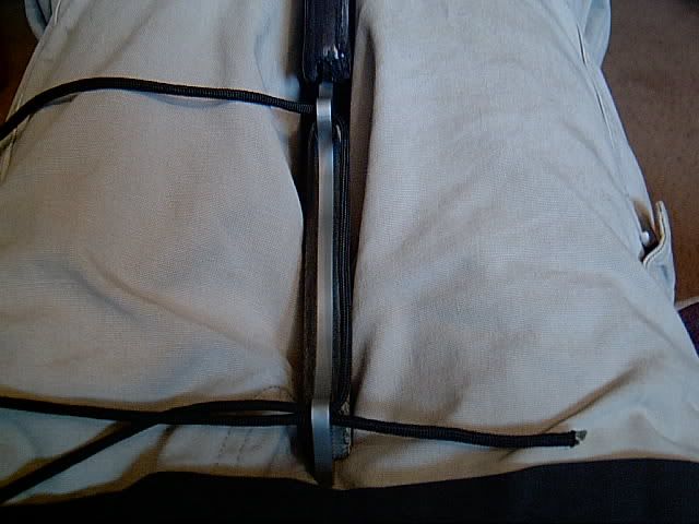

STEP 4: CONTINUE WITH THE LONG STRAND AND FEED IT THROUGH THE FRONT TALON HOLE RIGHT TO LEFT AND AGAIN, PULL TIGHT TO LIKING:
YOU SHOULD NOW HAVE 3 STRANDS WITH BOTH ENDS OF THE PARACORD COMING OUT THE TALON HOLES ON YOUR LEFT (in opposite holes):
