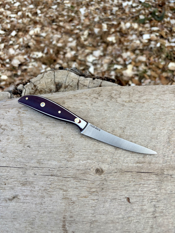

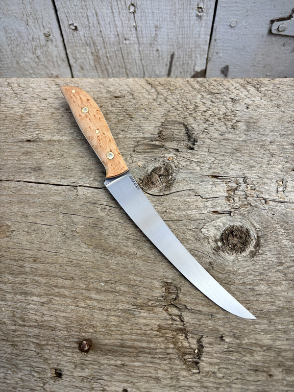

Curious of the specs on that new B&T model?
4” blade and 4” handle. .079” stock thickness. Some give but not much. I don’t think the blade length is totally necessary but nice for reach breasting birds. Might make a few in .04” aeb-l.
