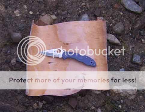

The edge profile was different on this one than the previous one in VG-10. The ZDP-189 version was slightly thicker at the edge but ground more acute. Specifically it was 0.022-0.025" at the shoulder of the edge bevel which was ground at 12.7 (2) degrees per side.
It was extremely sharp, even for Spyderco, well above shaving and push cutting newsprint. It needed 68 (4) grams on thread and 0.43 (6) cm on light cord under 200 grams of tension. It is the third sharpest knife I have measured to date. In fact out of the ten sharpest knives I have measured, seven of them, including the best one, are from Spyderco.
The high sharpness and acute edge transfer readily into high cutting performance on ropes and The Delica in ZDP-189 took just 13 (1) lbs to push cut 3/8" hemp and a bare 8.0 (5) lbs on a slice. Spyderco again dominates the rope cutting having eight out of the top ten spots (not including knives I reprofiled and resharpened) in the knives I have measured to date.

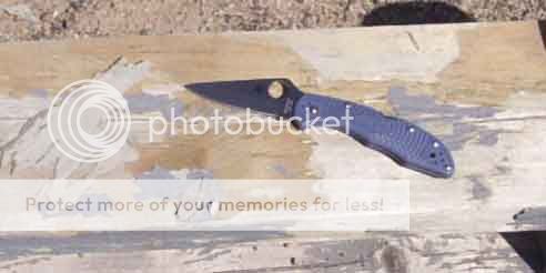

It also did well cutting hardwoods, birch flooring specifically, I need to repeat this a few times, but the performance seems solid. It will be behind some of the knives used with thinner edges and higher primary grinds but not outclassed. The high sharpness is very durable, lasting through the very heavy (75+ lbs) cuts through the hardwood and easily shaving.

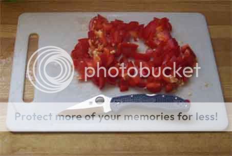

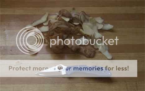

It works well in the kitchen, the high sharpness makes it cut into potatos readily though the heavier cross section compared to the Calypdo Jr. can be felt when working the knife through the peels. It is very efficient in handling, being light in the hand with a precise point which easily handles eye removal :

It also carved a section of 1x2 into shavings and resplit some spruce rounds into finer sections for firestarting. This finally removed the fine shaving ability which was readily restored with some light honing on 0.5 micron chromium/aluminum oxide on leather.

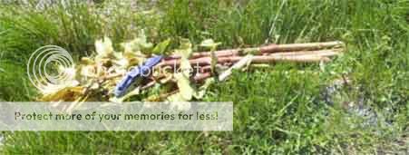

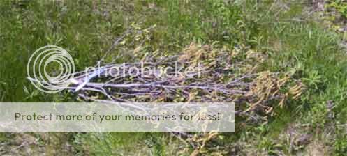

On some stalky weeds it readily pops them off with a light chop holding onto the end of the handle. This type of chopping is overkill with even a light hatchet and the Delica gathers the material quickly though a longer blade would be more efficient. The Catcherman works quite well.
The Delica also has enough dynamic cutting ability to cut some thicker wood. On Alders approaching the size of the opening hole it pops the limbs off readily and cleanly, again just needing wrists flicks. These don't burn well (wood is too wet), but they dry readily once cut, and also work well for a debris shelter and they make decent cordage once the fibres are broken. Mears demonstrates this on several occasions in his TV shows :
On the larger versions of the same wood, chopping isn't effective as the blade doesn't have the mass. You want at least something the size of the Endura to take out the ones that are about 1/2" thick and over. However by putting the wood under strain by bending it, the Delica readily slices them off :
On harder wood, even when the limbs are small, the Delica is too light to handle much chopping, but again putting the limbs under tension it readily cuts them off and an armful of boughs can be gathered in just a few minutes :

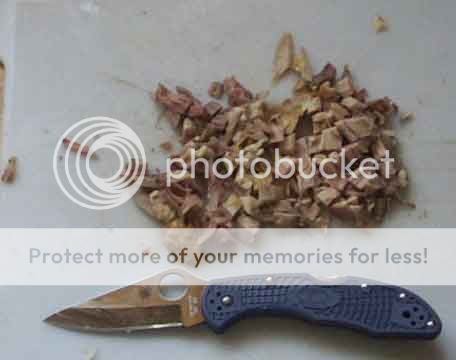

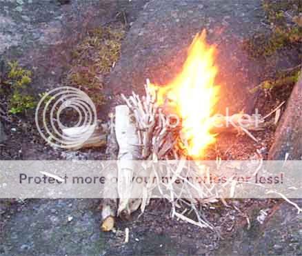

Now the thin shavings are just sliced off, and these burn almost immediately, very similar to paper. You would be hard pressed for example to cut them from wood as fast as they burn so they just get the fire going. The splits on the side on the other hand are easily ignited by the shavings and will burn for an extended period of time, on the order of ten to twenty minutes depending on wind and wood type :
This is easily long enough to gather some green woods for a smudge :
This will drive away insects, act as a signal fire, and also keeps rain snow off the dry wood, and it will also burn once it dries. This can then be augmented by other materials such as thick barks :
which produce a clean flame :

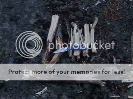

Now back to the grind, the sabre grind on the Delica allows it enough strength to use to pry the wood apart using light to medium wrist strain, so you rock the blade into the wood and then pop it apart and thus work faster and more efficiently. The danger in actually recommending this is that the tolerance isn't infinite and it is readily surpassed by aggressive loading by any normal adult which is why makers/manufacturers understandably don't promote it heavily.
Now of course a flat grind on thicker stock like the Paramiliary is more efficient from both a strength/weight issue and cutting/sharpening perspective than a sabre-flat grind, especially when you add in the distal tapers. It is very hard to argue for sabre-flat from that comparison on a performance based arguement but there are performance/cost arguements which can be made and general aesthetic ones.
As a side note, if the blade isn't robust enough to laterally pry apart woods, it may be still strong enough to take a torsional load as this will put a large component of the load through its width which is near impossible to break. Thus instead of rotating the wrist sideways you rotate it down. This is much harder on your but much easier on the knife.
This is speaking of course of making small splits, on larger splits you have to use wedges as prying is generally not effective unless the wood is fixed in place as in deadfall logs and then you tend to want much thicker blades at least 3/16" for the small ones and 1/4" for the large ones.

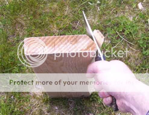

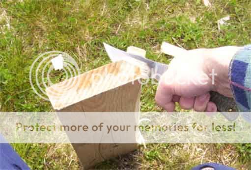

In regards to prying vs torsional splitting :
This is a Safari Skinner used to split a piece of lumber by prying. The blade is rocked into the wood and soon becomes stuck and you can't press it any further. However it you pry to the side it will split the wood as shown. You then advance it to the apex of the crack and repeat. Once you get familiar it is very fluid and you can run the blade down the wood in seconds.
This is the same basic procedure however it doesn't load the knife laterally but torsionally and the knife is many times stronger under such a load. It would even be difficult to break a SAK like that and they are trivial to bend laterally. You are also much weaker in that movement and thus it isn't very demanding materials wise on a knife to be strong enough that you will give out before the blade. This method can also be made very fluid with experience, you just rapidly rock the knife down through the wood.
For many knives batoning is generally a better choice, however this may be problematic for blades with distal tapers or locks, and they can still be very functional with prying or torsional splitting. Some times wedges are more effective, it depends on the wood and what you have available and time constraints and your physical ability. Someone who has very strong wrists can split even fairly large wood quite rapidly in the above manner with a stout knife.

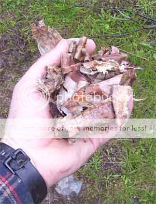

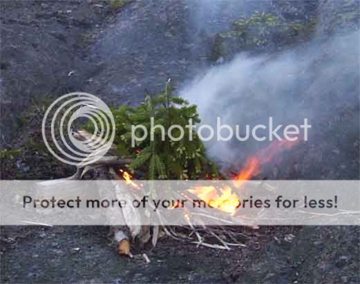

The gum also tends to get all over your hands so you need to clean it up or soon it will be on everything. This is easy though just rub your hands with sandy dirt. This abrades off the gum and once the dirt dries it comes off readily. On really damp days just use dry inner rotted wood or pine needles to dry the wood, or you pants. I then gathered some loose birch bark for direct tinder and placed it between my clothing so it would dry. You can just peel this off with your fingers though a knife edge makes it a bit easier and faster, it also allows you to scrap the bark to make it easier to light.

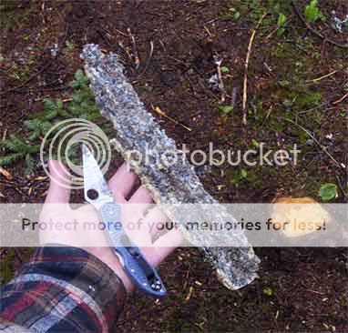

I then cut off a sheet to cover the tinder and protect it from the mist during the initial stage of the fire. I also put this under my clothing, I just wrapped it around my arm and put my coat back on. This of course has many uses besides fire starting. You can write on it, in large pieces it makes a rain proof shelter very quickly and you can make all manner of containers from it. The wood though itself is horrible to burn in contrast to the bark so you generally want birch and something else to make a fire, alders work well as does any close ingrowth. Birch is too sparce locally for that, I have never actually seen a piece of birch dead fall.
Usually you can gather small dead woods if you check around however I did some work on larger woods which needed to be split just to see how the Delica worked with batoning. I was using light wrist impacts so it took 10-20 impacts to split each of these small pieces of wood. With a heavy impact from the elbow they would go with one hit with the Temperance but I wasn't willing to see where the Delica would give yet. In any case it allowed separation of the wood much faster than by hand :
The large piece on the left was also cut in half by driving the point about 3/8" deep into the wood by hitting the end of the handle. I made six point holes on one side and rocked the blade in each hole (NOT laterally) to widen them and the wood then cracked easily. I also carved a bunch of it into shavings. The wood gets wet really fast again in the mist so it is best done under cover. If you have another person they can just stand over you and form enough shelter. However with the bark and pitch it wasn't a problem anyway as they will burn very hot and I just needed to get the wood in a small diameter, being damp would not prevent them from burning.
The wind was high enough so that all of the wood burnt to embers in about 15 minutes. Initially I formed a windbreak myself but once the birch starts to going and especially after it lights the pitch it takes insane winds to blow it out, it just tends to burn hotter. Almost immediately the fire it stable enough to burn even green wood. I immediately cut a small arm load of boughs with the Delica which make a nice white smoke once they start to burn :

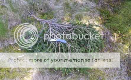

A serrated edge works better for cutting boughs on this size of knife because you can't chop and essentially have to slice the boughs off under tension. It you are really aggressive you can just pull them off when they are this small, but this is pretty tiring on something as large as a shelter and the long boughs which enable you to work fast are near impossible to crack off by hand.
