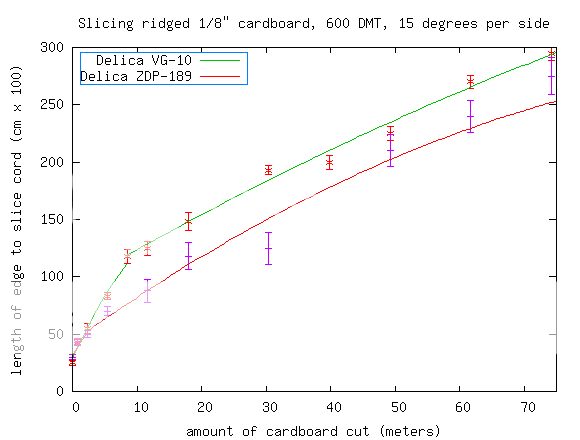

Yes, I want to repeat this with the same knives on another round of cardboard to allow for a more definate statement. I then have other ZDP-189 knives and VG-10 knives which will be checked to see if the performance is consistent. S30V and SGPS are obvious benchmarks as well once VG-10 has been established.
kel_aa said:
Do you think a different type of regression is needed for the ZDP to model the behavior? The later measurements have more dulling than the fitted curve suggests.
Yes, additional points would have been of benefit, the end points are always problematic and extrapolation is always risky. It may be that the high carbide steels may need a different model or at least an additional degree of freedom due to the edge stability effects noted by Johnston and detailed by Landes. I would see a edge retention model as being influenced by strength, wear resistance and carbide stability (for this type of work, corrosion resistance and impact toughness would be relevant for other work), secondary variables would be fatigue limits, resilence and ductility.
What do you think about ploting the recipicals of these values, as sort of an fraction of initial "sharpness".
This is what CATRA does and this would effectively plot sharpness, plus you could also scale it so the first points were at 100% which makes for an easy visual inspection. I did this origionally years ago however this obscures late stage blunting significantly because the inverses basically make anything beyond the initial rapid blunting pretty much zero. Consider that with an initial performance of 25 then by the time you hit 250 you are at 10% of origional sharpness. Even increasing this to 500 changes it only to 5% and this doesn't look very different on the graph which is y-scaled from 0 to 100. However the knife is twice as blunt and you can readily tell the difference when cutting. These difference are much more dramatic without inversion.
What do you make of the changes in behavior of VG at 10m and the large jump of ZDP between 30 and 50m?
The ZDP-189 point at 30 is just I would assume random deviation. Only 60-70 points are expected to lie on the fitted lines anyway, and you expect 5% to be off the fitted line by twice the predicted deviations. Once I rerun the data on another cardboard sample there should be more capability for a definate statement. As additional data, Spyderco has done CATRA testing on ZDP-189 which shows it at 750 vs 505 for VG-10 respectively which is in the tolerance of the above graph. Phil Wilson has shown interest in it and hopefully he will discuss his rope cutting work as well.

I would personally want to do more work with it before making a definate statment. I want to repeat the cardboard cutting with those two knives which is underway with a 1200 DMT finish now. I then want to see how they compare on really harsh abrasive cutting, sods and then look at push cutting edge retention on wood carving or similar.This should also be rechecked at a higher angle and at least one other ZDP-189 knife, optimally from another maker/manufacturer. I will also be interested in what Wilson comes up with as he is very frank and honest and can be counted on to give factual information with no hype. Based on what I have seen to date it is showing readily the effect of a lower grindability than the standard high carbon stainless, which is to be expected, and also better edge retention on abrasive media.
The exact extent and nature of the latter is still under investigation especially with respect to the nature of the influence of edge angle on stability. For awhile I figured that if you microbevel it would take care of any edge stability issues due to low primary angles. However consider a reprofile to 10 degrees and a micro-bevel about 0.1 mm wide which is thus about 15 microns thick. As the profiling here is done on a relatively coarse hone (800 grit waterstone is about 16 microns) and the scratches hit from both sides, it may be that the carbides are being torn out of the edge during the primary shaping and thus the micro-bevel forms on effectively a much lower carbide volume fraction.
This may be why the initial edge retention is significantly higher due to the hardness which would still be of benefit, but the long term isn't showing full strength to to influence of carbide tear out on wear resistance. Just conjecture at this point but would seem to agree with behavior noted by Johnston and Landes in similar (using the term loosely) steels. I am also still a bit bothered by the problematic consistency in the above ZDP-189 results, which could just be due to cardboard variation. I always benchmark carbboard with a stock blade through a given amount, so the cardboard is always marked with something like "Olfa, HD, 100cm/450 grams", and when I do runs I always random sample through very similar grades. However it is possible to get a sample with segregated high grit which can throw off a run. Again another reason to repeat this again. I generally would not go public which results at such a stage on a fairly unknown steel, but have been getting a number of emails about it so wanted to provide some information and hopefully encourage discussion/participation.
ZDP-189 also has an odd composition which I continue to wonder about. The chroimum is only slightly higher than 440C (20 vs 17) so why the massive increase in carbon? What is the extra 1.9% of carbon supposed to do with that 3% of chroimum? It would seem that all that carbon is just going to form cementite which is much softer than alloy carbides. It would seem more reasonable to use a harder carbide and get similar wear resistance with a lower carbide fraction and smaller carbides. However a japanese metallurgist strongly contended against the use of vanadium in knife steels on the Spyderco forum here but wasn't exactly detailed in his arguement.
What may be happening is that due to the powder metallurgy process the lower amount of segregation and higher distribution is forcing a switch from the type of chroimum rich carbides being formed. The chroimum rich carbides that form in 440C do so in about a 4:1 ratio with carbon (by mol, however the steel compositions are by *weight* so you need to adjust for that). However there is another type which forms in about 2:1 ratio where there is less chromium and I think a higher dispersion could induce this to form. If this is indeed the case then you would need double the amount to get similar carbide content and thus the higher carbon in ZDP-189 would logically follow. Again, conjecture on my part but it would also seem to agree with some comments about ease of obtaining a high sharpness which typically doesn't follow 440C to to the segregated and large primary carbides.

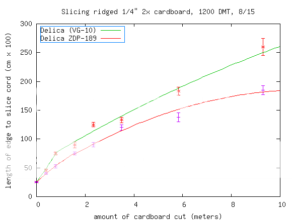

An update on the edge retention comparison of VG-10 and ZDP-189 in idential reground Delicas, here is the result of 6 runs with the VG-10 and 5 with the ZDP-189 slicing 1/4" double ridged cardboard through 4 cm of edge with the middle 3 cm tested for sharpness. The edges were set at 8/15, primary/secondary. This means a complete regrind flat to the primary bevel with a 0.1-0.2 mm wide microbevel freehand at 15 degrees per side. The 600 DMT results repeated for comparison :
and now the 1200 DMT results :
This duplicates the same behavior in many specific details as the 600 DMT graph which is always good. The VG-10 Delica blunts faster initially again and shows more blunting in the long run. Note the difference in the x-axis of the two graphs. Though comparing different card stocks is always problematic this gives you a rough idea of the difference in cutting power between 600/1200 DMT. I should have used more points in the latter stages as this would reduce the tendancy for radical drift behavior in the last point.The last VG-10 point in particular is I think on the high end of the actual behavior from looking at the raw data in detail.
On a critical note, the performance of the ZDP-189 blade was much more stable this time, note the very low variance. There was in fact no premature bluntnig as was seen in the runs at 600 DMT. However half of the six VG-10 runs did see such behavior meaning a run for each of the last three points for which the blunting was at least double what the median would predict. This confirms my hypothesis that this is a general behavior of high carbide steels at low angles. This could be checked by repeating the work at high angles, say 15/20, but quite frankly I have lost interest in knives ground at those profiles. I will be repeating the work with some low carbide steels at low angles to confirm.
I also got much better sharpening responce out of ZDP-189 this time, in all of the five runs the edge formed clean, no need to deburr. On three out of the six VG-10 runs a light deburr was needed. There is an ideal amount of pressure needed to form clean edges on steels and it is tricky to sharpen such different steels side by side and get both of them perfect. On an interesting note, a x-coarse DMT pad is actually slick on the ZDP-189 Delica and chews through the VG-10 one. A 200 silicon carbide waterstone chews through both like using a wood rasp on balsa. I will be looking at ZDP-189/S30V shortly, with Spyderco's S30V and the extending it to Wilson's S30V and Fallkniven's SPGS. I should for consistency check the three Spyderco ZDP-189's which is fairly uninteresting in bulk but would allow a check of the above proposed carbide issue at least. I have checked multiple Spyderco's S30V and they are consistent.
