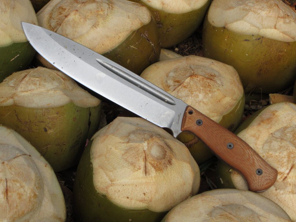

So I'm getting to the point where I need to touch up the edge on my Light Chopper. This will be my first time working with 3V. I use the knife mostly to open coconuts. I am curious, what do you all use your Light Choppers for, and how and how often do you maintain their edges?

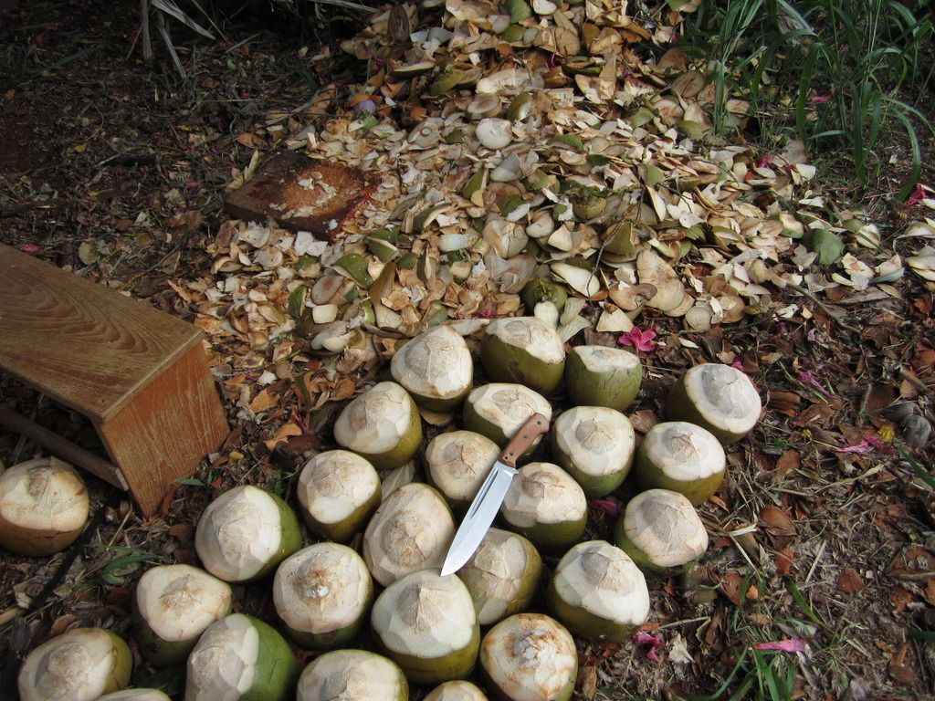

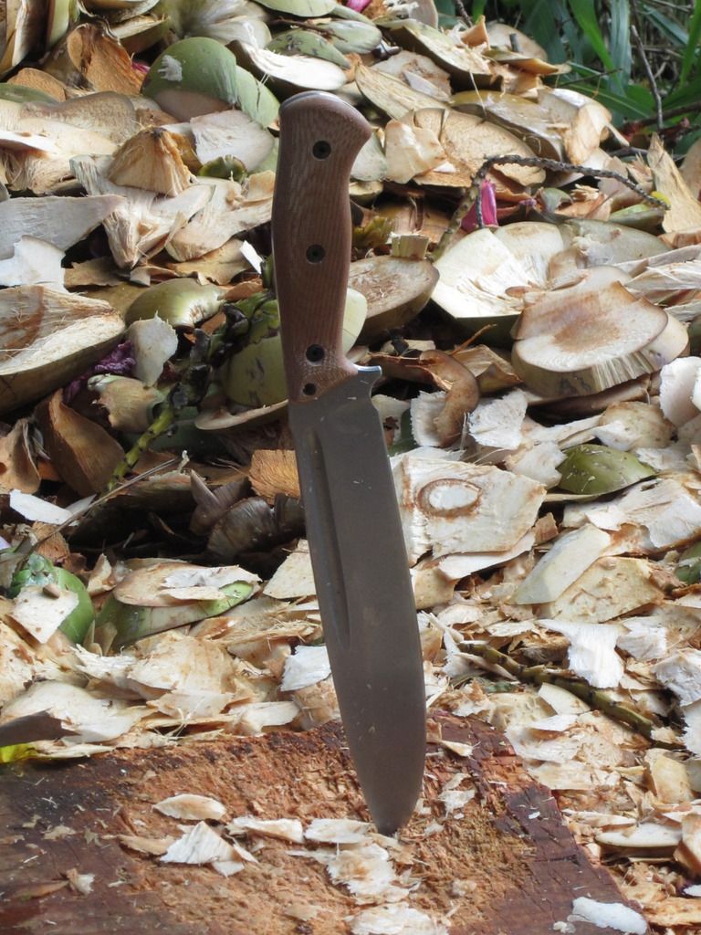

Dang burned through the factory edge already :)
How many coconuts do you think you processed?
Around 200. And it's not just opening the cocos. I shape them as requested for a local shop, which involves more work than just opening the nut. I chop and slice through the husk, and I'm not shy about twisting and prying with the blade buried in the husk. Also the knife edge impacts and slices the actual hard coco shell. Although it will still do a quick job of opening coconuts, it is noticeably more work than when it was razor sharp.
The knife is still plenty sharp. I wouldn't say I "burned through" the original edge. I prefer to maintain it than let it get dull.

That is very cool. We had real work in mind when we developed this knife, and ^ that is real work. I'm glad to see these being used.
I'm curious, how did the cutting ability, handle ergo and edge retention compare to what you'd been using before? I've never processed coconuts before.
