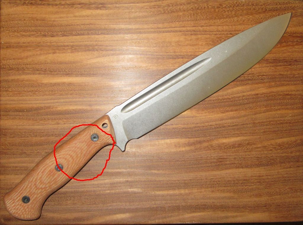

As far as the handle rub I had mentioned, I lightly smoothed my handle with sandpaper. In the circled area below, only on this side, I sanded extra, taking down the ridges in the Micarta to 1/2 or 1/3 of the original height. The edges of the fastener holes got special attention too, especially in the circled area. Now I can use it all day long without any skin friction issues. No grip issues either. You guys with grip issues must be wailing the holy snot outta your choppers! Or am I not seeing something?
