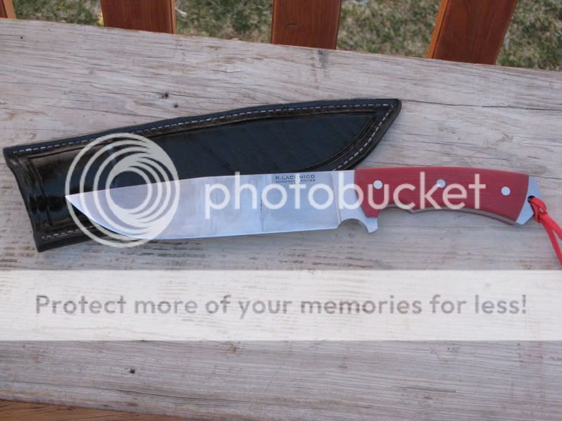

Here's one Ray Laconico did for me a while back that is very similar to what you propose. I love the design and it is one of my favorite larger knives. I particularly like the forward choil for use on smaller or more delicate tasks. In my opinion, it lends a lot of versatility to a bigger knife.

Laconico is the master of simplicity and I love that knife you got there. All my larger knives have choils but I doubt it's really necessary on this one. This, to me, is a small knife and a good way to choke up on a small knife is to put your middle finger where you index would go and tuck your index knuckle against the blade. Stretch your thumb down the spine and you're all set.
