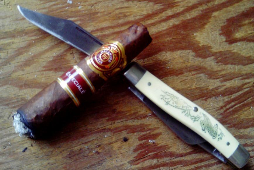

Yes a few times.I use a DMT green stone.Took the cutting edge on this one to <three inch and lowered the kick.
Yes. Here are a couple I adjusted....
The Schrade 505 was a factory second and the sheepsfoot was sitting way too high. I lowered the kick till it was just right and adjusted the spey to match it...the main got lowered a smidge too. Turned out to be a nice EDC for my 9 dollar investment.
The second was an old Case Jack that had been abused..It needed both edges re-profiled and the kicks lowered.
