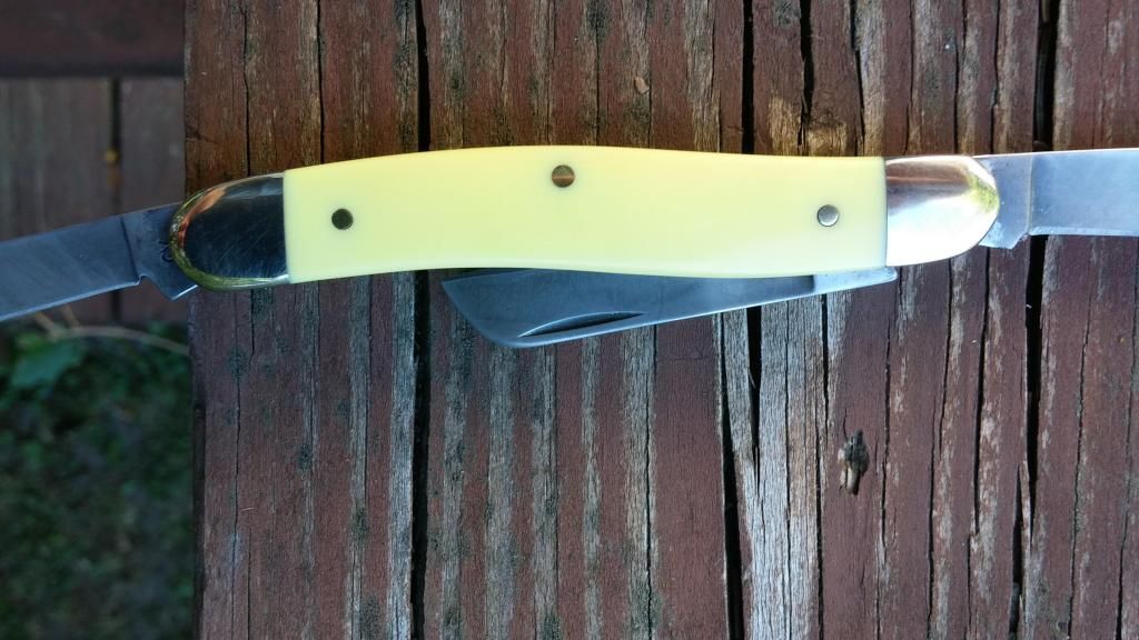

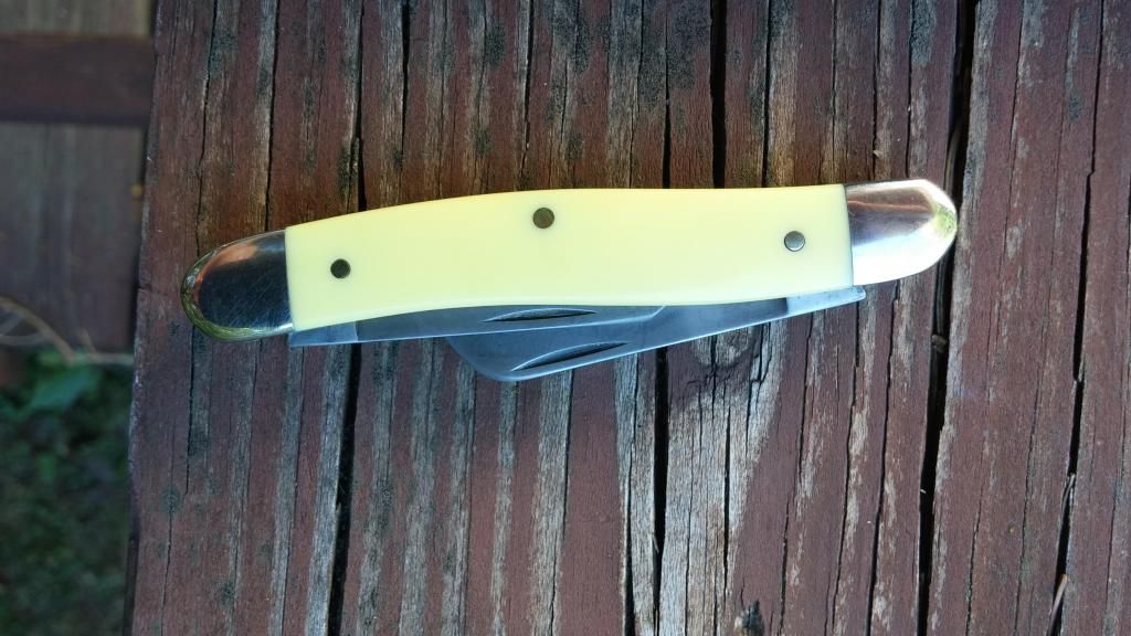

Well, I did it - I filed down the kick on my Case Sowbelly. It is very nice now. The sheepsfoot now sits just high enough for the nail nick to still be accessible. I did have to file down the brass liner a little on the back as it was then a little proud of the springs.
I do it on every stockman pattern that comes my way. I prefer the sheepfoot blade spine to ne parallel with the spine of the main blade, and so far I haven't found one that didn't need it.
[/URL[URL=http://s8.photobucket.com/user/kleingra/media/Mobile%20Uploads/20140928_143410_zps6b863e23.jpg.html]

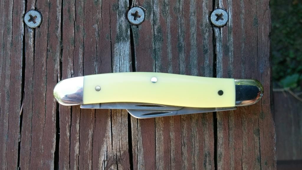

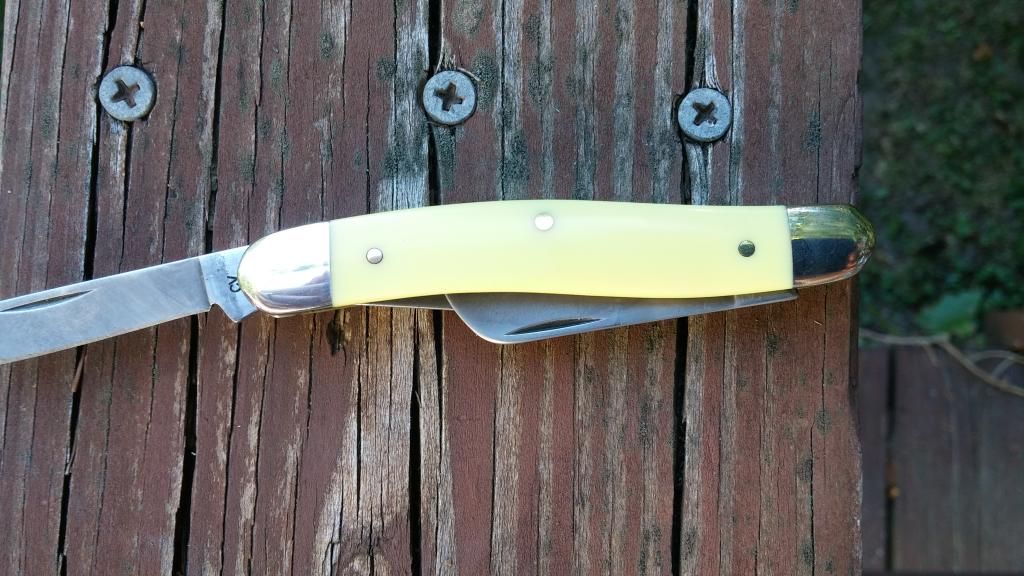

Before and after shots of my Medium Stockman. Used the file on my Leatherman tool and went super slow. I was really nervous about trying, but I'm glad I did it. Before the sheepsfoot was so proud it was uncomfortable to use any other blades. I think this will make the knife much more useable and enjoyable. As you can see I lowered it quite a bit. No noticeable effect on the backspring.

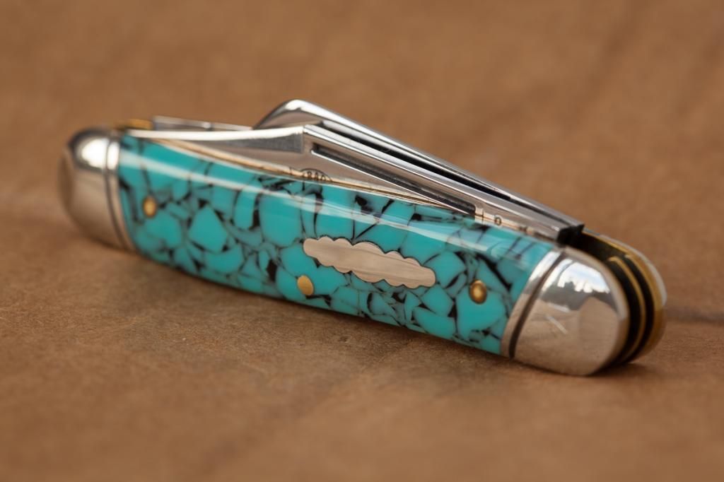

I lowered the sheepsfoot blade on my #66 Calf Roper by slowly and keerfully sanding its kick.
~ P.
Pertinux, I love that picture with the licorice. Beautiful knife and really great photo idea. The scales match the candy almost perfectly.
Yes. Nice concept and well executed -- a classic.
I lowered the sheepsfoot blade on just one knife, a #66 also.
