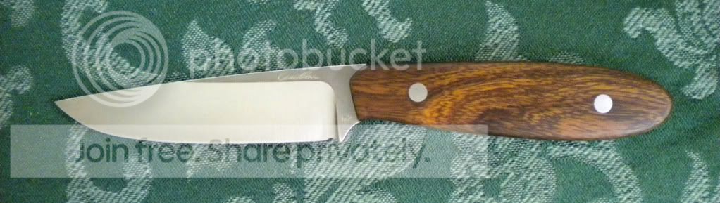

Right now, my most common process is mill, 120, 220, 400, HT, 400, scotchbrite. I get a pretty respectable machine finish:
http://i566.photobucket.com/albums/ss107/Nathan_the_Machinist/101410/1.jpg
I get about five knives up to 220, then probably 2-3 out of the 400.
