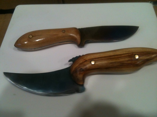

Don't get rid of your first knife. I didn't finish the first blade I ground, and honestly probably never will now. Here are my first two blades.
Number one:
Number two:

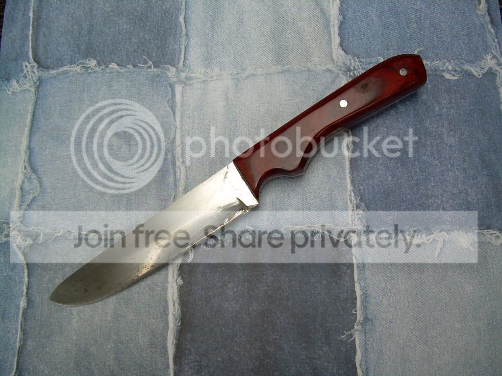

My first:
ATS-34 steel with micarta handles and corby rivets in the handle I didn't do the HT a member here was gracious enough to help me out. Somewhere on here is my neurotic WIP of it lol. There were no real regrets to doing it the way I did except I got a 2x42 grinder while I was working on it and decided to use it to speed things up a bit. Then I spent more time after using files and sandpaper to fix the fast errors I made with a power tool. I'd say 90% of it was done with files and sandpaper. Echoing what others have said in here don't settle for "good enough" take your time through every step and make sure you complete every step to the best of your ability before you move on to the next step.

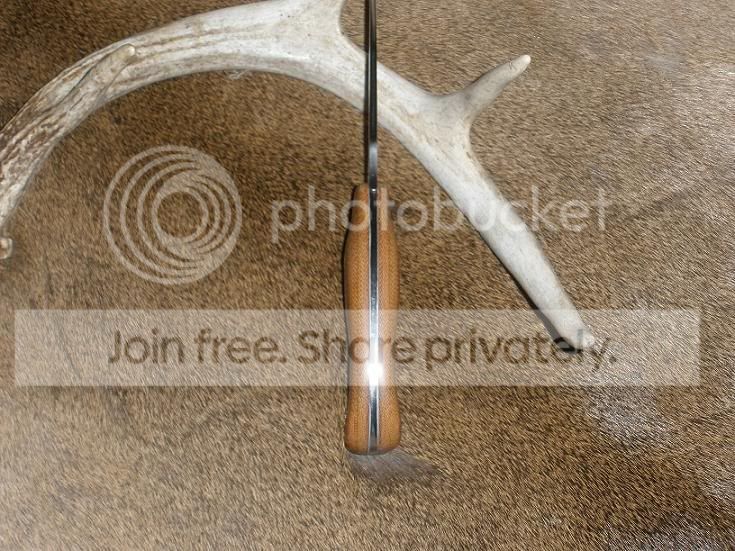

Hey Blank Space,
You asked so I'll play along. My first was just about a year and a half ago. I did my lurking on here and some other sites to glean all the knowledge I could and chose to go with some of Aldo's 1084. I really wanted to try the Heat Treat myself (I'm stubborn like that), and I have been happy with the results. This knife field dressed, skinned, and quartered several deer and wild hogs last year and preformed much better than the Buck 110 that I carried for years prior. I even use it when we do the final butchering on our game and it holds an edge quite a bit longer than the commercial knives that I used previously. (I did get a friend with a machine shop to test the hardness for me and it came out at Rc 59)
Scales are teak scraps that I had lying around with brass pins and carbon fiber thong tube.
I think that it came out pretty well for a first effort, especially when you consider that I did the whole thing with files and sandpaper. The only power tools I used were my bench top drill press, and a bench grinder to help smooth in the profile after cutting it out with a hacksaw.
Of course there are things wrong with it, but you learn from your mistakes and the goal is to make each one better than your last. It does get easier each time you build a new knife, so don't get too overly concerned with your mistakes along the way. Learn from them and try your best to fix them. This will teach you more about how to better the next one than anything.
