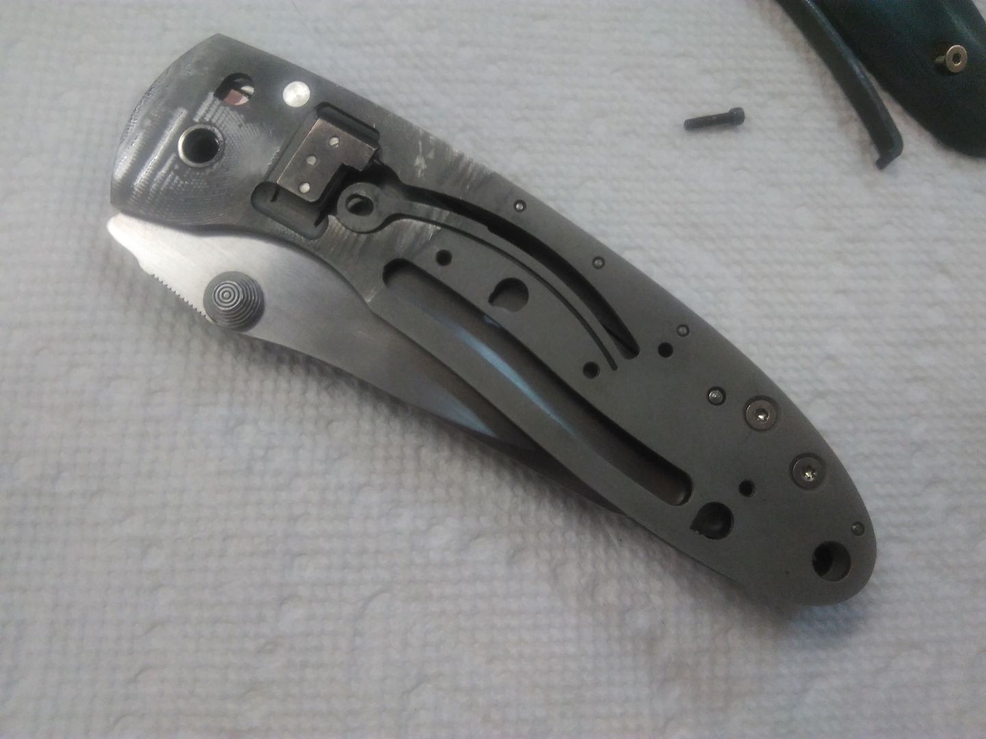

How were you able to reassemble the pivot insert that is on the clip side of the knife? I took mine apart but I can’t seem to get it to back in.
If I understand you correctly, the pivot (circled) has a flat side that needs to mate with the flat spot on the lockbar scale (arrow). The flat sppot (key) on the scale is oriented not quite 6 o’clock (5:30-ish)
Reassemble from the show scale up.

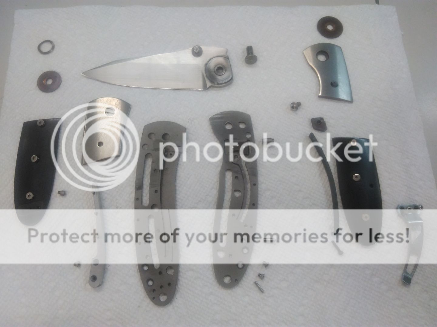

Rear standoffs —> pivot —> stop pin —> large washers (phosphor bronze against blade) —> blade —> small washers.
When it’s time to drop on the clip-side scale, mate the flat spot of the pivot with the key in the scale then rotate the scale to align with the stop pin and standoffs. Alternatively, you can put the scales into alignment first, then rotate the pivot until it falls into the clip-scale key.
I hope that makes sense. Good luck.

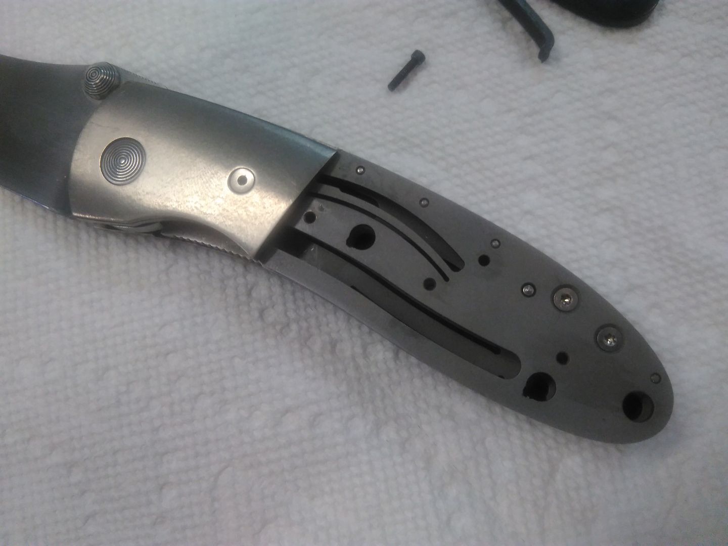

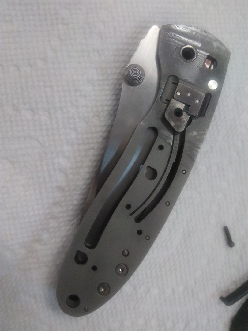

P Pndapuff Here’s a close up of the pivot. It needs to go through the show scale first. Because of the way it’s keyed, it wont go all the way through the lockbar scale. The screw goes in through the lock side.
Also, my washers are 2:2.
A few more pics. Show scale:
Lock side:

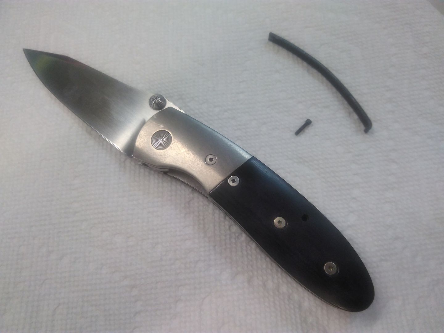

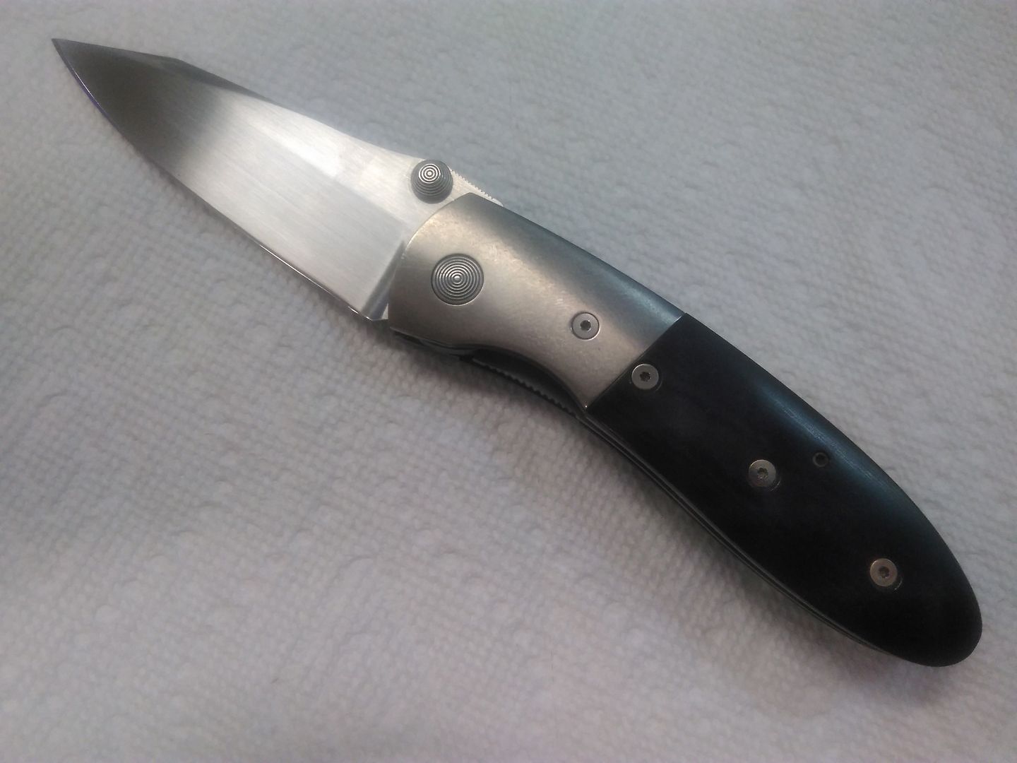

My buddy’s Tenatious was so jacked up, I insisted he let me give it a spa treatment.
Look closely. There are two things missing (the most important one I found—thank goodness!).
Stop pin (found) and a scale screw (somehow vaporized to another dimention)
ETA found the screw 6 weeks later; somehow it made it into an open package of cleaning swaths...

Nope, this thing won’t mate at all. I’ve tried with the blade and without. I have no clue what I am doing wrong, but I feel pretty damn dumb right now. So it won’t go in the full way correct? Mine goes maybe a third of the way in and jams up.

Well I have figured it out, while I’m too ashamed to say why it wasn’t working, your pictures helped me figure out my horrible mistake. But I’m sure you can guess my boneheaded mistake, lol Thank you!
