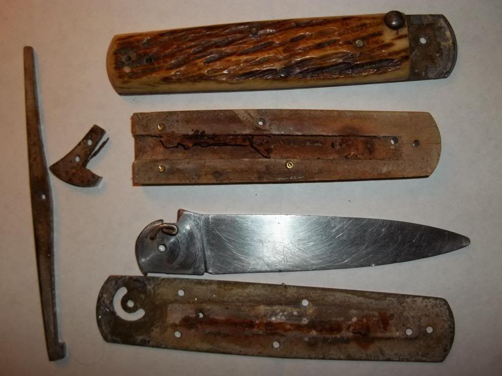

Disassembly pics?
Try leaving the pivot in the freezer for about 10 minutes. I had an SKS that the fit was so tight that I had to put some of the pins in the freezer before I could put it back together.
You could also freeze it with canned air turned upside down but don't hold it in your hand. I have done this with press fit bearings with great success.

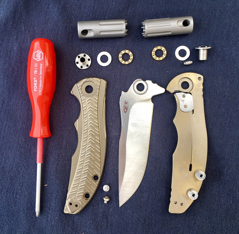

ZT 0609
A bit of pivot adjustment really helped this guy.
Notes for posterity:
Free spinning pivot; thread out from the show side.
Lots of factory locktite = lots of heat needed.
Placing leverage bars through the STP Tool holes was mandatory!
T8 spacer screws. :thumbsup:

I discovered there are bearing races against the Ti. Obviously they’re pretty well fit and I didn’t see them at first. Are there any other ZT’s that have races against Ti?
Nice pin spanner tool.:thumbsup:
