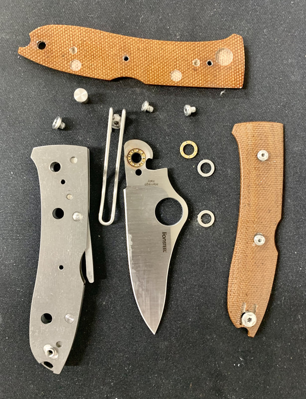

Disassembly pics?
All cleaned up

Very interesting picture ! Thank you for posting it and thank you for posting so many others ! I particularly enjoy the Microtech pictures, I like to open up my auto Socom one day but have to get better tools than the one I have.
I believe l saw a Wiha set on this picture, in your experience is it a particular set you find useful for disassembling folders or you’d go with just T set of allens? TIA
For folder work the sizes I've needed are Torx bits #3-10 and occasionally standard/metric allen. I like Wiha the best, but Wera is also a great brand.
General question. For bearing races as in the above North Arm is there a right or wrong way to face the open and closed side? Thanks.
I dont think it matters much since the bearings turn in the machined pockets of the scales and/or blade depending on the model of folder. Ive seen them Installed from the factory in either orientation.
