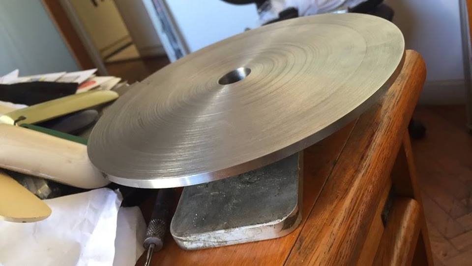

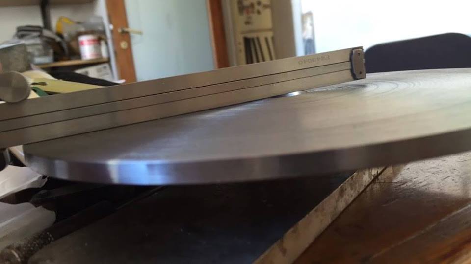

Hi Kevin, can you share the blueprints? I already have the motor, vfd and plate and this comes like just in time manufacturing. Will touch it here and there so it fits my motor. My email is pablou at gmail
one degree taper
Thanks!
Pablo
one degree taper
Thanks!
Pablo
The taper shouldn't matter. If I had a tapered disc I'd just glue some 60 grit on and push the table into the spinning wheel to true up the table and keep the gap tight. I can send you the file the next time I'm at work.
