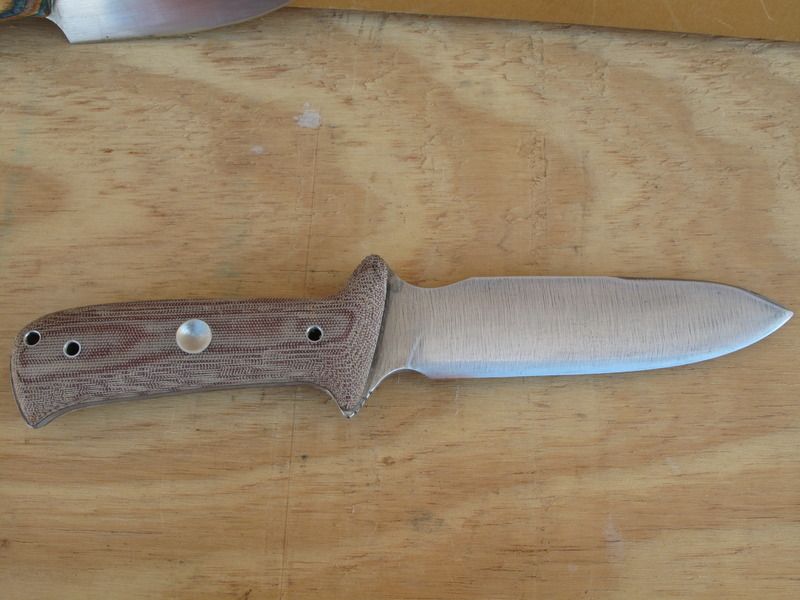

I am VERY interested in watching this progress. Maybe a passaround on one of the early ones? It is so hard to ber certain on detail as everything becomes a compromise. My simple answer on the spine- make it sharp- if the buyer does not know how to stone the edge to break it to their preference, maybe they should not handle sharp tools.
I hope it is not gosh to include the below pic- the maker no longer makes knives and this one was made to my specs. The thumb scallop edge is softened, the middle is a sharp spine, the froward portion was well rounded-with a 1/4" long swedge just enough to cleanly cut fibers in drilling. A one off to please this buyer but a range of options.
Thanks,
Bill
Thanks,
Bill
Thanks for your input Bill.
I find it quite interesting on all the differing opinions about how the spine should be treated.
I will for sure round the first inch after the handle for the thumb, after that it will likely be customers option.
Thanks for sharing the pic of your "One Knife" concept.
I like seeing others ideas for what they want in a do-all knife.

:) The person I was working with wanted me to throw the kitchen sink at them and it was a chance to make the ultimate compromise knife so I could try ideas out.
I have subscribed to both threads and would like very much to try this design of yours. It looks like a real winner and your reputation for functional using knives is tops.
