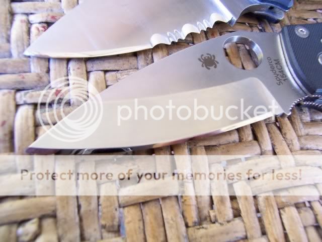

After reading many threads praising the DMT continuous stones I decided to give them a shot and see what I could get out of them. I got the coarse, fine, and extra fine stones and went to work on reprofiling my Manix2 to 15 degrees per side. Let me throw my praise out there for these stones. They make sharpening so easy. They cut fast and clean. The scratch pattern is very nice and even with all three stones and make for a short time of sharpening. I was able to bring the bevels to the edge with the coarse stone much faster than I anticipated. Even just with the coarse I was able to make the Manix2 nice and sharp. I then followed with the fine and extra fine. All three stones made for a really sharp knife but I wanted it sharper and with a mirror finish. I don't have the extra, extra fine DMT stone so I used my Spyderco Ultra fine stones, then used strops with white, and green compounds and then finished with Mothers mag and aluminum polish on a leather strop. After all this I got the Manix2 amazing sharp. I can shave hair with ease off my arm and treetop really well. I can get it to whittle hair too. but still no mirror finish. Any advice? Did I just not use the fine and extra fine stones long enough? Do I need the EEF stone? I have used the same stropping process after using my Sharpmaker and got a nice mirror finish. Here is some shots to show the experts what my finished result was. Any advice would be appreciated. Thanks

That was me freehanding. It's not as exact as I would have liked. You can see in some of the pics that I had some trouble at the base of the edge.
You guys are nuts:D. My freehand on my Duosharp stones never look that neat and perfect. More of a sloppy convex with a hell of a lot of scratches.

Agreed! But I'd like to get that. DMT makes little cheater bar clips that you can clip to the spine of the knife to hold various angles until the muscle memory gets honed. I just saw them in a video yesterday. It's not as manly but hey, they work! :D

I used to make my own using short lengths of thin plastic tubing. Just slice the tube along its axis and slide in the blade. Stiff tubing works best.

Very nice :D
When you swing them through the air do you see water vapor? ;):eek::p
Slackin on the serrations.........
