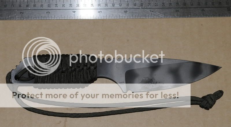

Been looking at some bushcraft knives from some of the makers here and elsewhere. Is there anything that they'll do better than my Strider SA? (pictured below) What advantages, if any, do they have over this knife?
Specifically here, I've been considering some of the knives in the Fiddleback Forge line. I know the workmanship is top notch, but are there any specific recommendations from Fiddleback (or other makers) if you think that the Strider will be a disadvantage?
I realize that the smoothness of the handle of these knives will cut down on the discomfort if I have to use it for an extended period of time and that they'll probably be a bit lighter. Anything else?
Forget about whatever "bushcraft" is, or isn't. Does your knife do the things you need it to, as well as you would like? Then you're set.
I will say though, that for prolonged work, I'd rather have a nice, full handle than a paracord wrap. But like the rest of it, that's just personal pref.

Alternatively, you could think about making handles for the strider? The blade geometry looks alright for “bushcraft“-like tasks.
You can always take the cord wrap off and put G-10 or micarta scales on it. I had a Strider MFS that was perfect and my brother "borrowed" it a few years ago. It's all about what works for you...
I'm not sure about the thickness of your Strider, but most of my Fiddlebacks have 1/8" 01 steel, I like thinner steel for wood tasks. Also, while having a handle vs. cord wrap, you will also experience less fatigue from not gripping so thin a handle design. I have the FBF KE Bushie and Bushfinger and have one or the other anytime I'm hiking, camping, or just generally woodsbumming. But, again, it's all personal!

Thanks for the responses. The Strider is a bit thicker than most bushcraft knives, it's about .19". It doesn't slice very well, due to its thickness, and I think that's an important property of a bushcraft knife.
Since that photo was taken, I rewrapped the handle using ungutted paracord as the base. It was a bit too small for my hand. (It comes standard with gutted cord) The rewrap extended the paracord much further up the blade. It's more comfortable now, but still, I realize, that if I used it for any extended period of time, unless I'm wearing a glove, it will be rougher than a standard handle.
One thing that I do like about it, that I haven't seen on many bushcrafters is a big "step" between the grip and the blade. Once, as a friend did some work with the point of his knife, I watched as his hand slid up onto the blade and cut him pretty badly. That could be a disaster in a serious situation and at least, a PITA in any situation. I know that a guard will interfere with any fine work but still ... Could someone make a recommendation for a knife with such a "step" or some other way of keeping the fingers away from the blade?
Get a set of Frag Grips from monkey edge (exclusive dealer, last I checked) for the SA and you won't have to worry about the paracord chewing up your hand. If they, too, are too rough you can sand them down and/or fill in the gaps with Epoxy or JB Weld.
It may not fit the stereotype, but you could certainly do a lot worse than the SA for bushcraft-type work.

+1. That knife is fine but the handle is going to be its limitation for extended work..

Isn't a choil at the back end of the blade but in front of a guard (if the guard is present)? The knife I showed in the first post in this thread has a small choil at the back end of the blade, just before the sharpened edge. I'm talking about a step in the handle as shown on that knife behind the blade, about where the cord wrap ends.

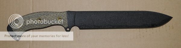

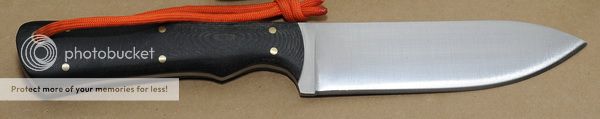

I got this knife on this forum awhile back but the grip was too small for my hand, so my wife inherited it. It has the design that I'm talking about.

First that strider looks like its hollow ground (could be wrong) which I find to be the worst for working wood. The thinness of the stock with the only with the paracord will end up killing your hand ( And in "bushcraft" I've come to the realization that you actually don't use your knife that much. What you do use it for mostly, or I do at least, is to play around carving notches (for traps and fire boards) and sharpening ends, and make shavings. Sometimes I split sticks with my knife, but in actuality, its entirely unnecessary.
Also most "bushcraft knives" have about an inch where the cutting edge runs parallel to the spine of the knife, this again aids in cutting wood. You can notice on the strider how the cutting edge curves all the way from the plunge lines to the point. Also I'm going to go out on a limb and assume that that strider knife is made from thick stock 5/32nds or more - which is too thick for a knife in the -4'' committee. I would go for anything 1/8 (.125) or thinner. If you really get into it you'll see what I mean.

The typical bushcraft knife will be a million times more comfortable than that handle, I can tell you that. It won't "do" anything your knife won't do, but it will do things more efficiently and with fewer problems. For example, a good scandi ground or flat ground will be better than that hollow ground. A thinner blade with a blunter/stronger tip will be better for just about any bushcraft cutting task. Typical bushcraft steels (O1, 1095, A2, etc.) will be take an edge easier and be much, much tougher and less likely to chip than S30V. The list goes on.
In short, yes, if you plan to bushcraft, you will find the above suggestions superior to your knife. That said, you can still use your knife to do everything you need it to do, just less comfortably and with more potential problems.
