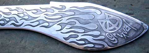

Clich how long did you let the enchant sit on the blade? Does it sand off easy? I did this with my cutlass but I dont think I left it on long enough because I can sand it off.

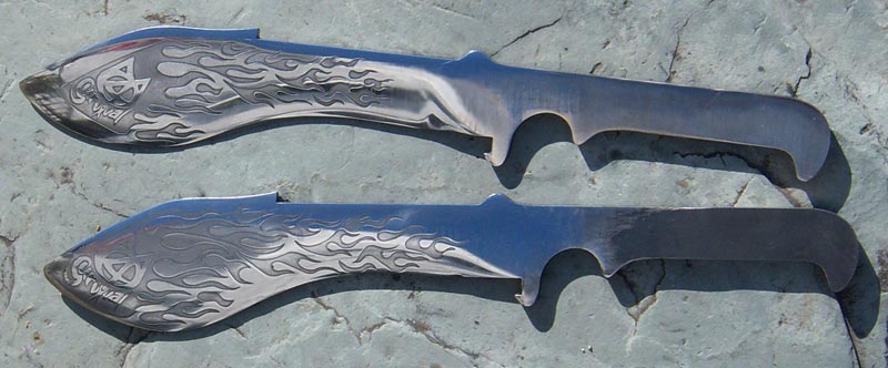

2 hours. I didnt want it too deep is it was on the grind. My original idea was cursive words on the flats but the letters were hard to work with that small. If i was on the flats i would have left it sit for alot longer but i didnt want to screw with the strength of the blade. Its only about as deep as the blue bleach etch. Just deep enough to be permanent and show contrast
I will have to re-try mine.
