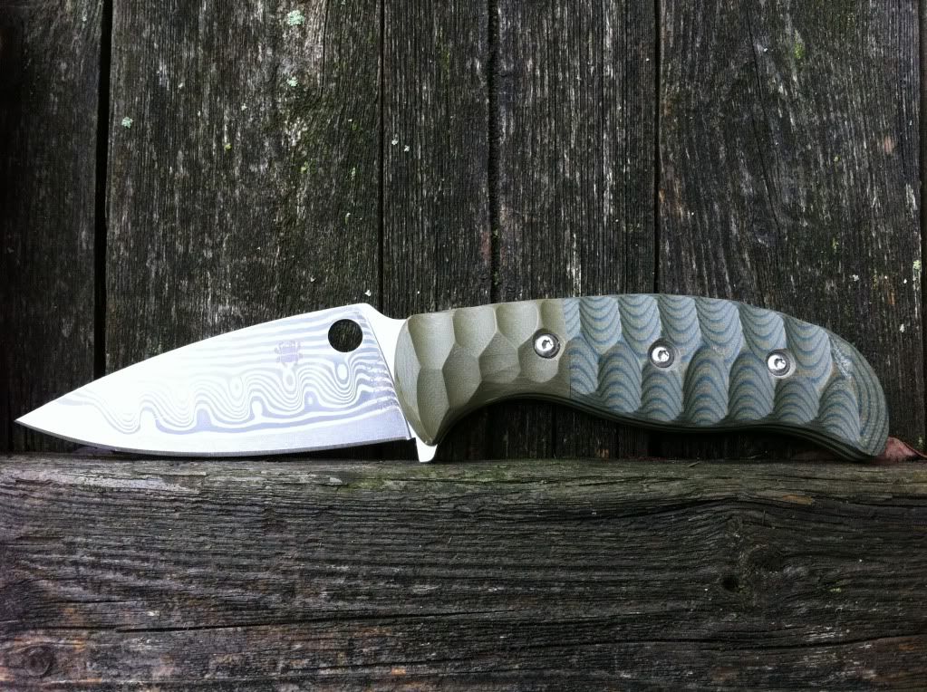

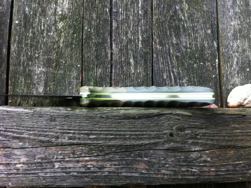

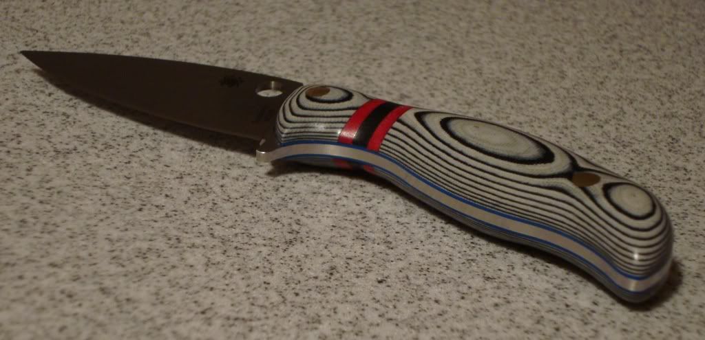

Thanks everyone for your comments. Yes, mosaic pins still planned. I'm wanting to shape the handle to look like this
And you bet I'll put it up here to show when it's done. I even have another M390 blade, g10, and mosaic pins to make a 2nd knife. I'm trying to perfect my technique and get the 2nd one perfect. Don't be surprised if you see it in the for sale section in the future ;)
i personally dont prefer that color combination, but his work usually is pretty good quality. he has my respect as a knife re-handler.

Here's my M390 Mule, needing a bit more work. Used G-10 for the scales, red micarta and black tex-tuff with blue plastic spacer. A bit beefier than I wanted, but it fits my hand better that way. I need to even out the left and right sides a bit more.

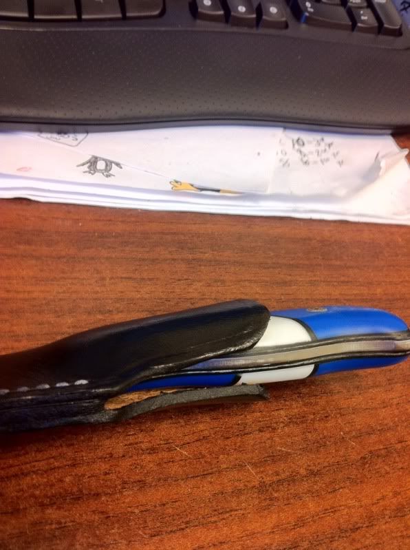

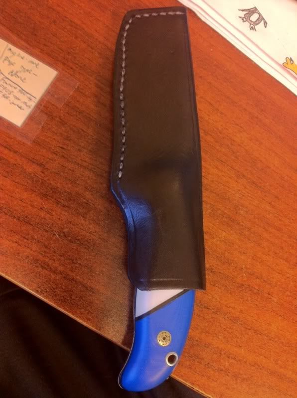

Finished!!!
I learned (for the next knife) not to double up the liners bc as you can see, they start to fray and the glue starts coming out. Also, I need to clamp down the butt end better and line up the mosaics.
Overall I'm very happy with it and can't wait to start on my 2nd one. Not bad for my first knife, right?
