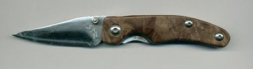

The first folder I ever made was given to my brother and he lost that years ago. The original walnut handle cracked on that one once and I replaced it years later for him with some stabalized maple I think it was. Spalted but it was stabalized whatever it was. It was really rough! :D The blade was from a used paper mill blade. This paper mill blade was circular like a circular saw blade but with a highly polished straight edge which they used for cutting rolls of paper. The paper mill where my family all works in the area where I grew up in West Virginia used to toss them out and the stacks of these blades were in stacks taller than I am in places. Its still like that to this day. They are not high stainless as they will rust but I'm not sure what they are. They cut well I and thats all I know. They made pretty decent blades if you wanted to invest time in getting a blank out of one of them but they all had to be smaller knives and getting a blank out of one of them without ruining it was a bit tricky. I managed though on more than one occasion by using thin cut off discs and a dremmel and simply cutting them out. Took lots of patience and time doing that let me tell you. It is really not something you would want to do a lot. I never did do things the easy way though. There was an innocence to that back then. I look back and shake my head with a grin at some of the things I used to do to say I made a knife. I'd do it all over the exact same way though! ;)

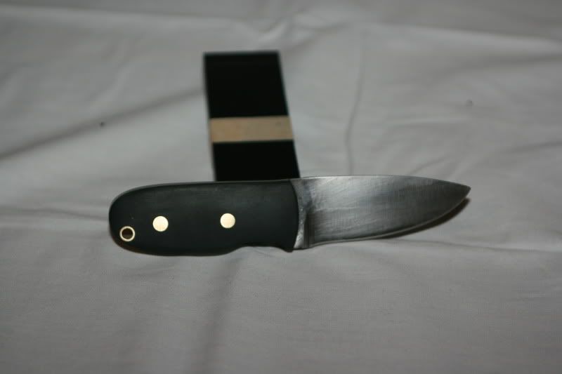

Here is a pic of my first finished knife,
(stock removal d2, sent out for ht)

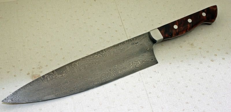

Here is a pic of the last knife I completed a month or so ago
Everything done by me including making the damascus and doing the ht, the thickness at the spine by the bolster is .088 iches)
Elapsed time, 2.5 year.
