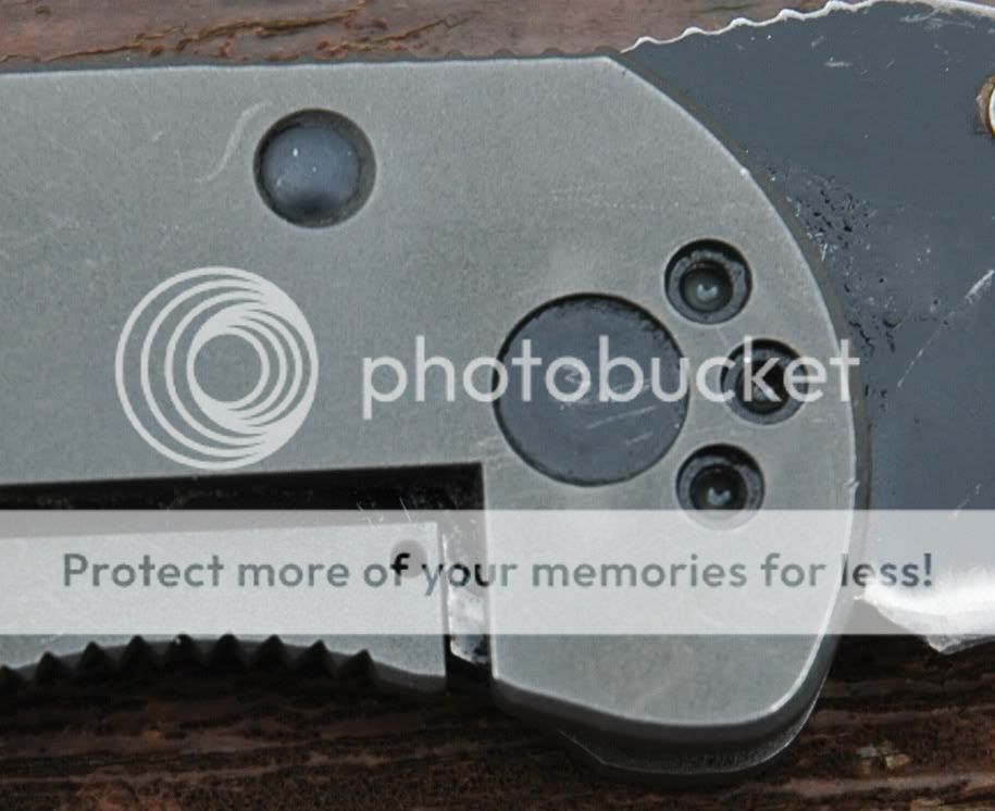

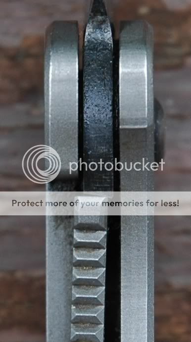

Here's my Pinnacle. As you can see, there's not a lot of room for wear left. It still locks fully and hasn't failed, but some play has started to develop.
Nothing lasts forever if you use it constantly, I guess.
