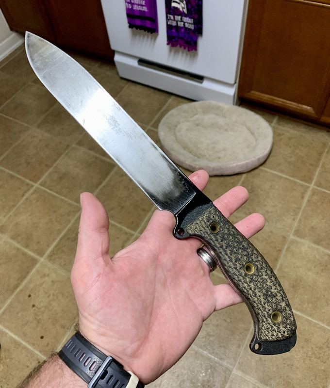

I got this custom from Bill Siegle for about the same price a few years ago and I think it will out-perform the TM in several areas.
It’s in boring old 5160 which is partly why it was so reasonably priced.
The TM is a cool design, and if they had made the handle a bit more durable and less prone to detachment then I might have gotten one…

You asked does anything beat the TM. Yes, lots of knives do IMO. But, lots of knives don’t. I’d say this one spanks it by leaps and bounds.
