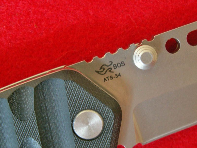

I've seen both 154CM and ATS-34 advertised and I don't remember what the blade said on the one I gave to my brother in law. Properly heat treated (and from Buck, it will be) you wouldn't be able to tell a difference. Honestly, if your purpose is toughness (which I kind of think IS the purpose that most people associate with this knife) then 420HC's superior ductility and finer grain structure will handle more rough usage than S30V will, even if that choice became available. S30V's greater abrasion resistance will win-out with a great deal of cutting on abrasive media (cardboard) but if all you're doing is opening boxes then a thinner blade profile would suit better anyway.
Mine is from last year but has a 2009 date stamp on it.
I believe the CSAR-t knives started out with ATS-34, but current models may have the 154CM as Buck seems to have phased out ATS-34. The properties are very close to one another, and I doubt you could tell the difference, especially in the CSAR ;)

Had to check, my CSAR-T is ATS-34 also.
