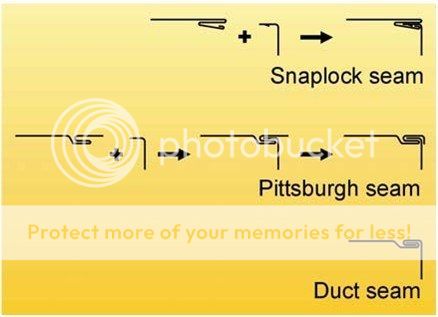

Straight cuts, I use angled hand snips to make round cuts. It's fun to take something flat and turn it into something three dimensional, there is a lot of math, metal grows when bent, you also have to allow for connections, and I use a type of seam to attach the pieces called a Pittsburgh seam.
I use snaplock also you have to add for all the folds and the 90 bend etc.
