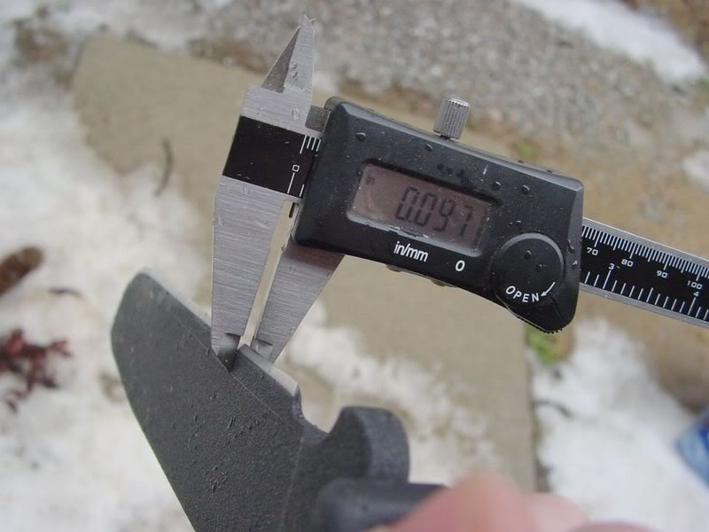

Just for clarity, the Dog Fathers are CNC ground to a .030" edge thickness prior to sharpening. Below is a pic of a digital caliper set at .0975" and a line that was scored up on the grind bevel to show how high up on the grind you must go before reaching this thickness. You don't reach this thickness until you are approximately 5/16" or .312" from the edge.

Dear God. I ground quite a bit further than I'd thought...
Thanks for the info, Dan. You probably already know how I feel about the knife. :thumbup: :)
Thanks for the clarification on the thickness issue. That makes quite a difference. Dave- according to the line scribed on that blade in Dan's post, it looks like your new edge bevel must actually be higher up than the choil!
:) You took off 5/16"?? Or did you simply convex it to that point, which is a different monster....Taking off the full 5/16 may be a good idea if you had any fractures, but i would have fully convexed the whole blade after doing so to retain the same geometry as the original blade.
Something just ocurred to me: are the official measurements counting the thickness of the coating? The reason that I ask is that the website mentions a thickness of .275", while mine is just about .3" at the spine. I'd figured that that was due to the thickness of the coating but it wouldn't hurt to double check.
I don't think I took quite that much off...I still have a choil, after all. ;) I'm getting ready to go to sleep now, but I'll take a picture of it tomorrow or the next day. I actually did consider convexing the whole thing but I'm a bit partial to the finish.
I'd hate to think my calipers are off. I measure COL with those. :o That would explain some things, though...

I lied about doing it tomorrow. Here's a pic from one minute ago:
attachment.php
The darker gray on the edge is oil and dirt smears.
Perhaps my measurements were off? I obviously went down a few mm but I don't think that I ground down too far.
