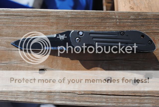

Just got my blade back from Richard. Amazing job. I also polished the pivot on it. Got it as close to mirror as I could without having any polishing compound. Its reflecting black off my nikon so its even shinier then it looks. It opened great before, now its just butter...
Thanks again Richard!

Closeups of the edge please. Those shots are too zoomed out to properly gauge edge quality and finish.
Edit: And I'm seeing some potential sharpening defects near where the serrations starts. Can't say I'm very impressed at all just yet.
