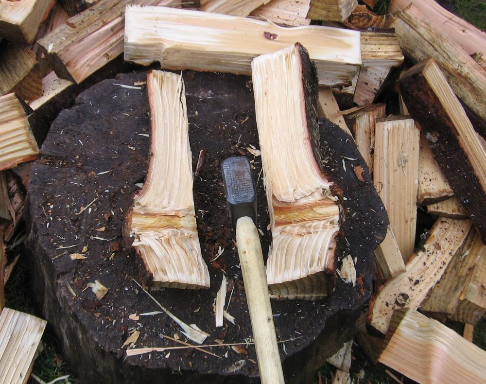

It's good to have a few tools available for spitting. I personally like to have a double bit at hand for straight grained wood. They are my favorite splitting tools because you can sink it into a split half laying on the ground and pick it up without being over. I like an 8 lb maul for the tougher pieces w/o straight grain or with knots. A wedge and double jack are great for the really tough pieces.
All are pretty easy to come by and if kept nearby are easy to grab depending on your need. A good splitting block also helps reduce the amount of energy you use. You bend over less and it's safer plus it adds some weight behind the piece you are splitting.

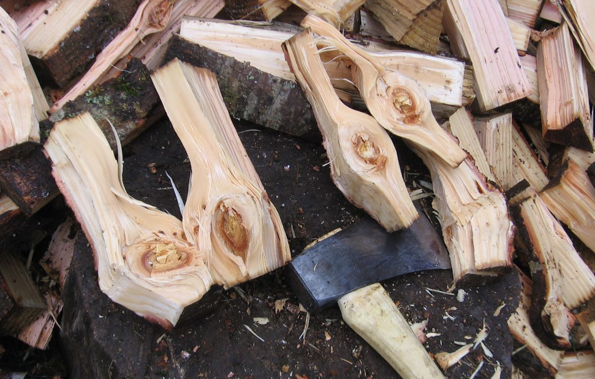

A couple years ago I got into some London Plane - toughest stuff I ever split. Coarse intertwined grain. Much tougher than even Elm. It laughed at my maul. The larger rounds soundly rejected my wedges. That's when I learned a trick. Put a very slightly hollow ground bevel on the tip of the wedge and it will stay stuck. Then nothing made of wood will stop it. Mostly I use a single jack with wedges. A stubborn piece draws a double jack.

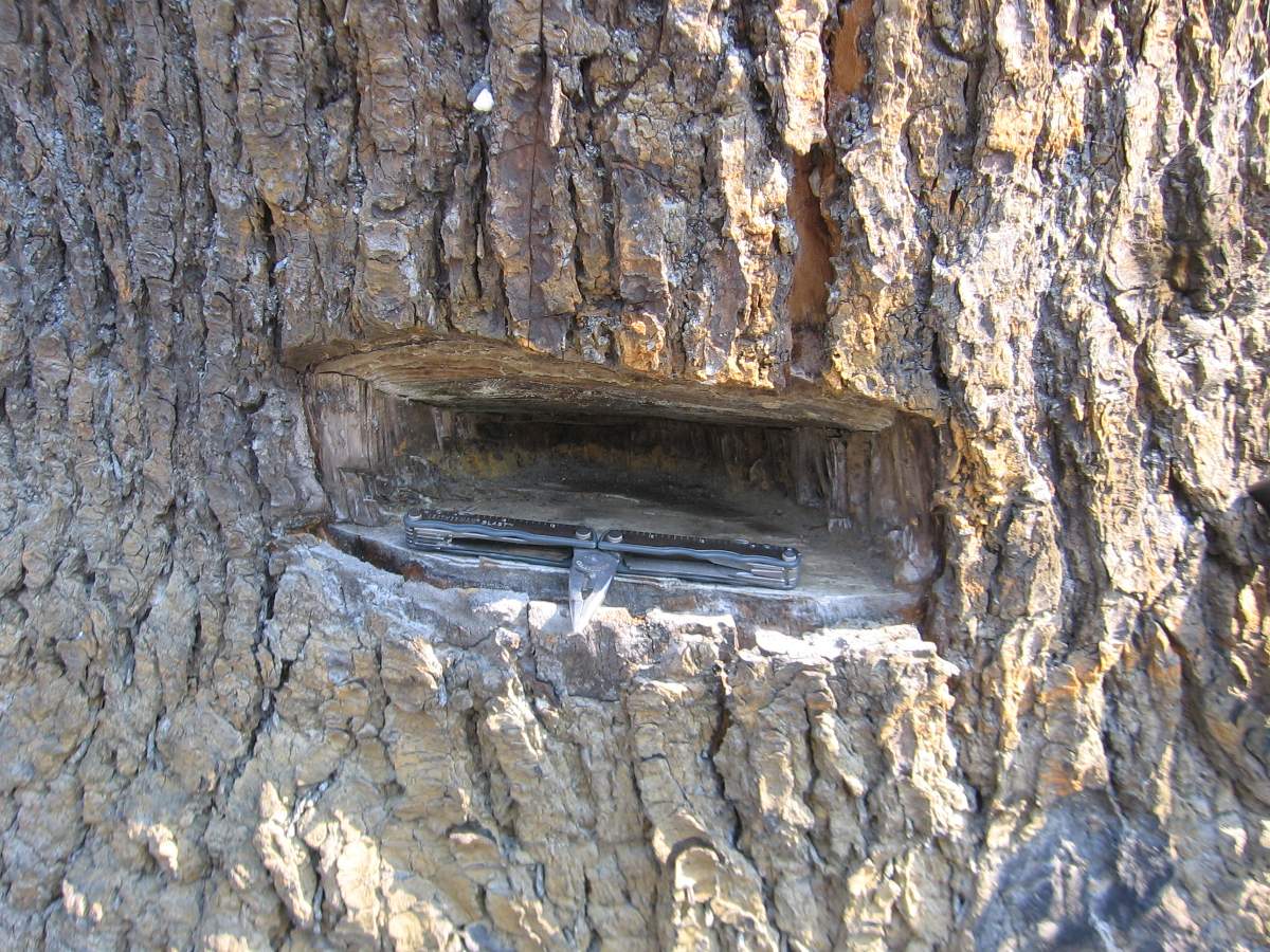

Back in the day of crosscut saws and axes most trees were never felled with a cut close to ground level. These were all large old growth trees. Frequently, more often than knot, they began life atop a nursery log or nursery stump. This resulted in big fat "bell end" trunks that were rotten in the middle and had no value as lumber. Considering the human effort that went into falling and bucking such a tree, no effort was wasted cutting wood that woudn't go to the mill. So the springboard was invented to get the sawyer up above the bell end and into wood that was profitable.
And to set a springboard you needed a deep notch. Sometimes a sawyer worked on a single springboard. Other times a pair of springboards were used as the base for a makeshift scaffold from which the sawyer/axeman could gain access to a large cross section of the old growth tree.
A few years ago I was fortunate to find a bunch of perfectly preserved springboard notches. In 2012 and 2014 the Elwah Dam and Glines Canyon Dam were removed from the lower Elwah River, built in 1913 and 1927 respectively. In 2014 I hiked the Glines Canyon and observed springboard notches that had been preserved at the bottom of the Glines Canyon Dam reservoir for 87 years and just revealed a couple months prior.

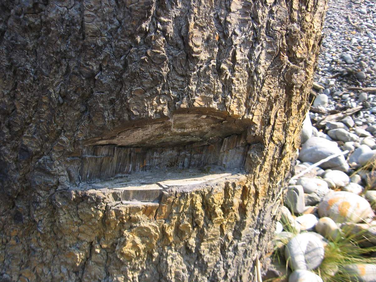

They appeared fresh, as though they had just been cut. It was startling how wide and deep these notches were. A special axe was needed to form them, a long bitted axe, the Puget Sound falling axe.
This notch is almost 12" wide and 8" deep. My Leatherman is open 8" wide for scale.
In some notches every blow of the axe was plainly visible even after 87 years!
After some time of looking at these photos and considering their significance it became apparent to me why and how the Puget Sound falling axe evolved. The long bit was necessary to cut the springboard notch. And the long handles, 36" minimum, gave the sawyer/axeman access to the full width of the trunk of these old growth trees.
