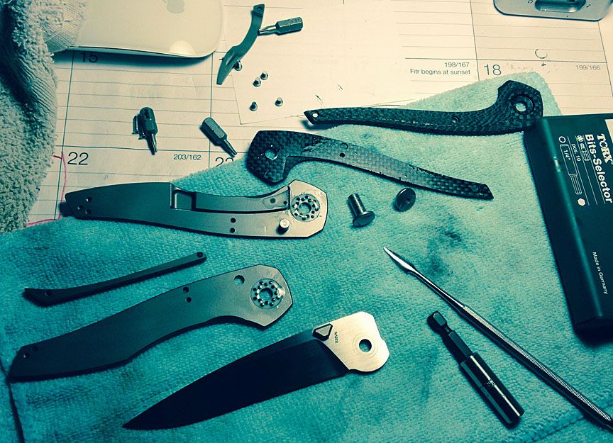

I just received the bearings, the dimensions are as following,
Ball diameter - 1.588mm (1/16')
Ball material - ceramic
Cage OD - 13.47mm
Cage ID - approximately 6.1mm
Cage thickness - 1.03mm
Cage material - plastic
Inner row diameter - approximately 9mm
Outer row diameter - approximately 11.5mm
I would like to post a picture but don't know how. Anyway I'm shipping it today, hope it will be useful to Scrim.
Hank, This is very nice of you. Please think of a way I can return the favor!! I will post here and contact you once they arrive. I will also take photos of one (or maybe more) of my clones that (I will disassemble AND I suspect) use these MRBS bearing disks and verify that the ones you sent are in fact the same (or a different diameter) than the ones used in these popular MRBS clones and Kevin John "original designs" that I own...only because I think it will be interesting for members on this thread to see. I will then post photos of my findings, in this thread. I thank you again, in advance, so very much for this kind gesture, Hank.:thumbup:
In the mean time, here is a photo of my disassembled CKF Suhkoi...which I suspect is using the same MRBS disk...
