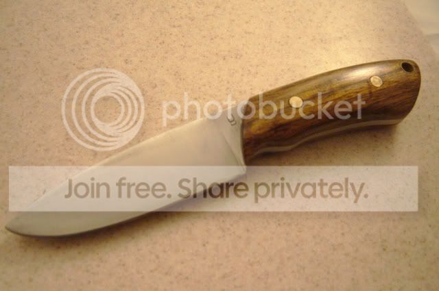

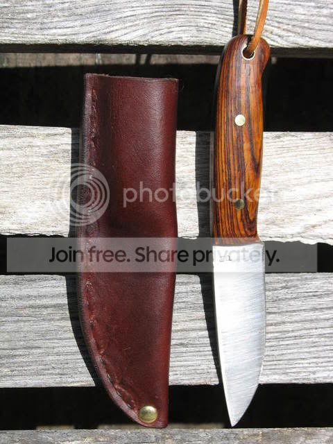

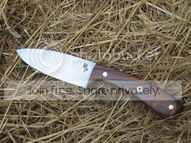

I always liked a large chopper with a 10-inch blade when I was a kid. When I grew up a little I was ok with a 9-inch blade, as long as I had a 4-inch fixed blade with me. These days I am gravitating more to the smaller fixed blades. A neck knife was ok as long as I had a chopper or beefy fixed blade. You know the reasoning we all go through to select our gear for a camping trip or hike. I like 4-inch blades so for me to pick a blade that was less than that was a real, coming of age moment for me. Yes the 1095 blade is 3 ¾-inch overall and sports the same cutting edge. I like a blade that starts right out of the handle. It says “let’s get to work” and that’s reason enough for me. Overall length is 8 1/8-inches. The handle- I saved this description for the end. It is the nicest looking handle I have. Coco Bolo wood with two 3/16-inch brass pins, and one ¼-inch black hole mosaic pin. Classy and hand filling, 15/16-inch thick, the length on the handle is 4 ½-inches.
Weight-6 ¾-ounces (knife only), 8 ¾-ounces (with Sheath).
RC 59-61.

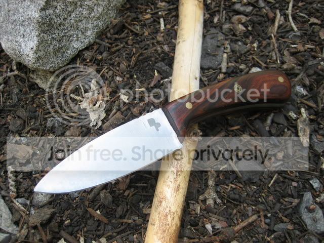

The Outdoorsman was carried on a 17 mile day hike from Mt. Baldy to Lytle Creek in Southern California. If there is one place I wouldn’t want to go without a sturdy fixed blade its Lytle Creek. I can only describe it as rugged and unforgiving. Steep trails, snakes, and lots of fallen trees would sum up Lytle Creek. If anyone has ever seen that movie “The Princess Bride” then you will remember the fire-swamps, that is Lytle Creek!

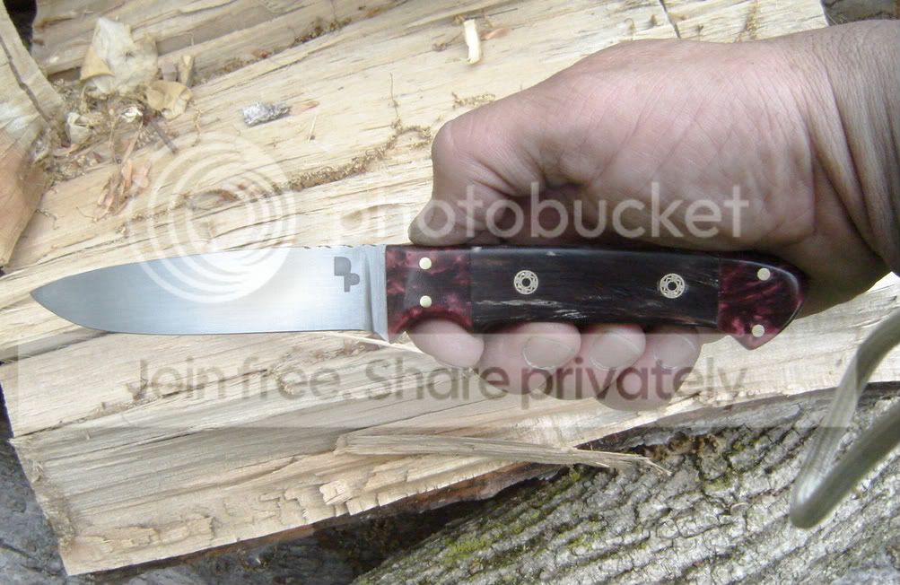

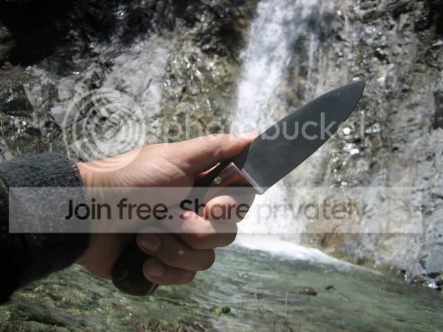

In hand shot

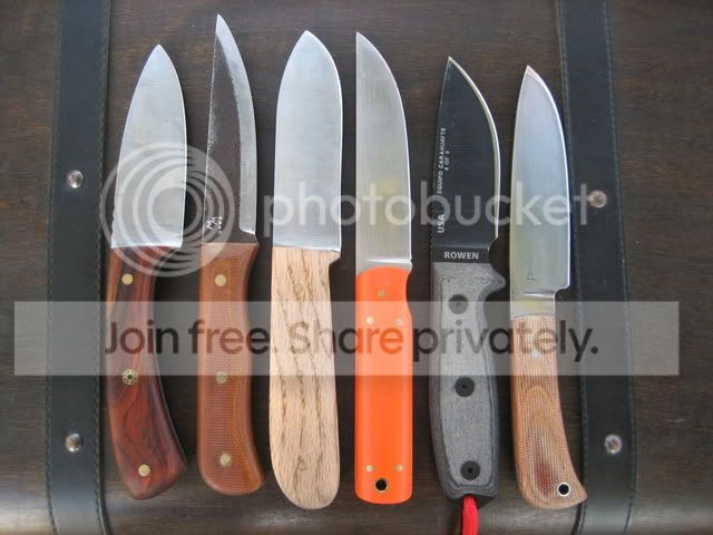

Size comparison
Left to right: DP Outdoorsman, Muskrat Man Puuko, JK Kephart, Breeden Kelly, RAT RC-3, Fowler Stone Mountain

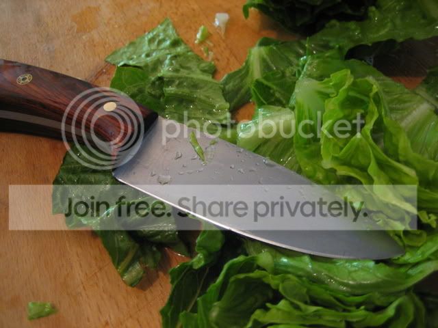

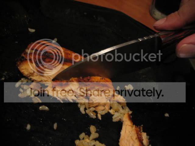

Food prep consisted of cutting vegetables, fish, fruit, salame, and cheese.
Using a knife 3/16-inch thick at the table is a little overkill. The reason for doing this is to see how it will cut different kinds of food without having to hold the knife in a strange uncomfortable way. The Outdoorsman is good for cutting food at the table but I don’t really like the idea of the nice edge hitting the plate over and over, yet I will baton with it. Does that make sense? I didn’t see any chipping or edge roll. There was no Patina or rust on the blade after about three weeks of use despite the somewhat rough finish, hand rubbed 220-grit. I only wiped the blade with a wet sponge and dried it with a towel, that seemed to be enough.

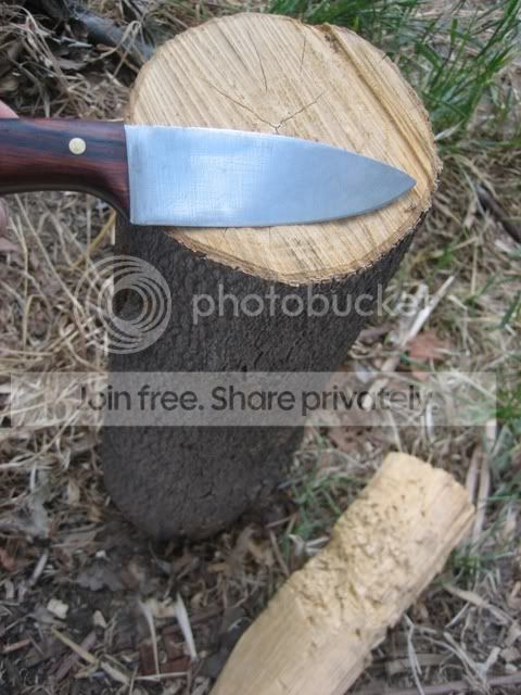

Baton work with a smaller blade takes a little patience.
It takes a little longer to split up a thick log with a 3 ¾-inches long blade. This is much larger than I would ever want to split with a knife this size, but if you really had to the DP would be just fine. For test purposes I used this 4-inch thick log but usually don’t use anything larger than wrist size pieces of wood for shelter poles and firewood.
Splitting off some kindling was easy with the stout 3/16-inch blade.

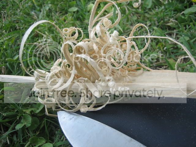

I did the fuzz sticks at the end of the tests this time. I had a feeling it would be ok. After the brutal baton work on a 4-inch thick log I decided to do some more delicate work. The fuzz stick was nice and curly.

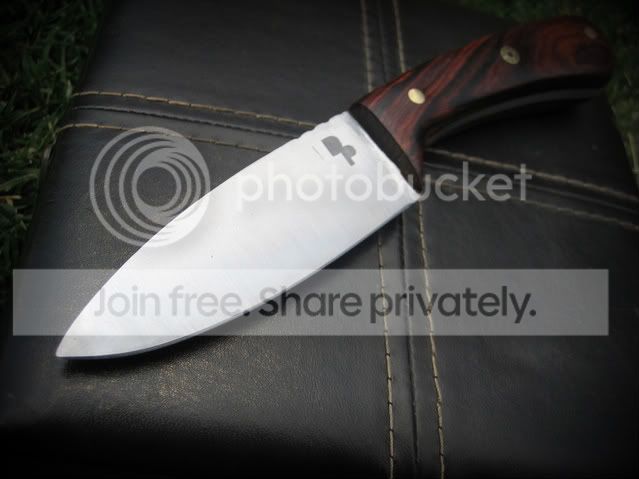

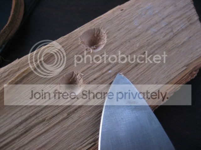

Tip Strength-I used the Outdoorsman to drill some holes in some thick wood; the tip seems to be good at this task. Normally I would drill a hole with the Awl on a Swiss Army Knife then make it wider by using a sharp pointed knife. This tip seemed just right for that. DP lists the Outdoorsman as a drop point, I agree but it is very close to a spear point.

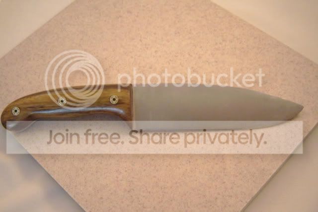

DP Woodsman with Amazique, 3/16 1095 full tang full taper grind, 3 ¼-inches blade, 7 5/8-inches overall

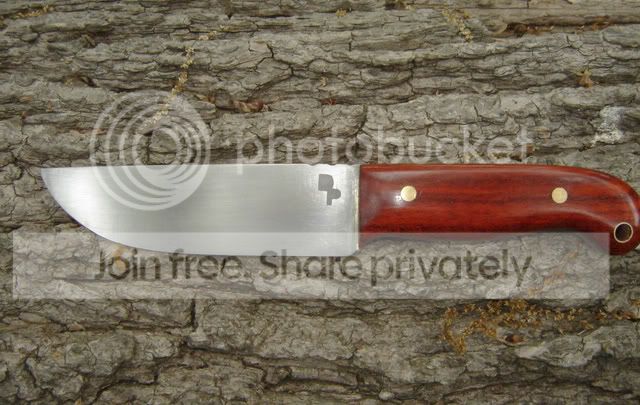

DP Hunter in Blood Wood
