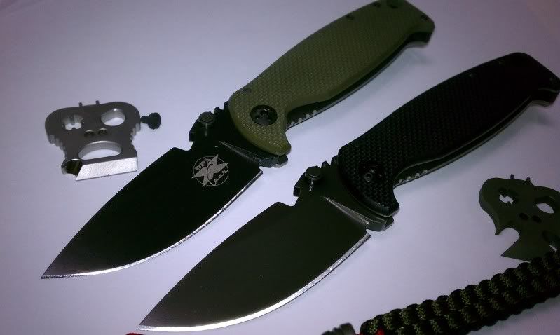

In order to create a perfectly good quality multipurpose utility tool, it will take years of effort, dedication, and contribution. A perfect tool can only be created if it has input from the owners of the company, all the way to the consumers of the tool being purchased. A perfect example of those contributions would be a Spyderco Endura being a folding knife with a history of 21 years in the making. DPx Gear has been working including taking the input and opinions of its costumers, implementing them to create what I consider to be one of the best folding knife designs to date.
The DPx HEST V2.0 locks up like a tank and has excellent engineering designed into the lock up.
The G10 handles feel to have a tiny bit more grip and the steel liner has been removed with the G10 now becoming thicker in comparison to version its previous version. Since I can notice the weight differences on folding knives, the knife immediately felt lighter from the moment I took it out of its newly designed box. The box feels to be of much nicer quality than the previous version as it is wrapped around with Mr. DP Logos.
The improved detail did not stop at the box, when inspecting the Hest 2.0, I noticed the edges are now refined in all the correct spots. When I opened the knife, it felt solid and difficult to open. This brought a smile to my face as I am an enthusiast of Strider Knives and appreciate knives with a break in process. Something similar to when I buy a new pair of shoes.

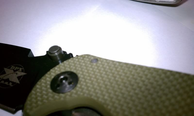

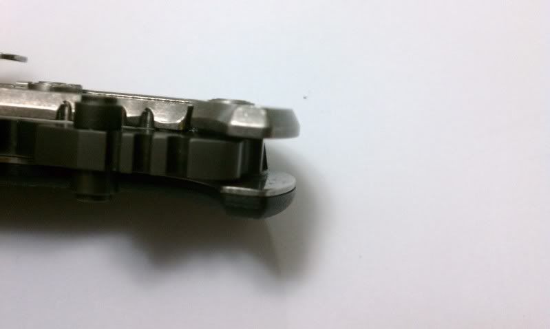

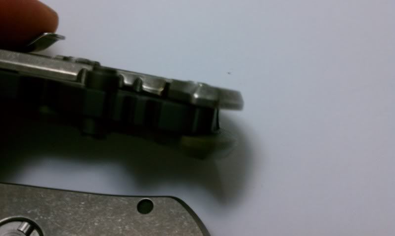

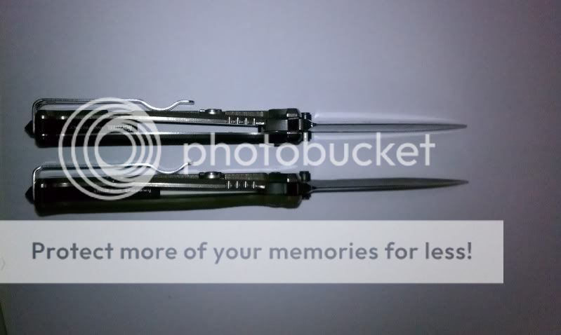

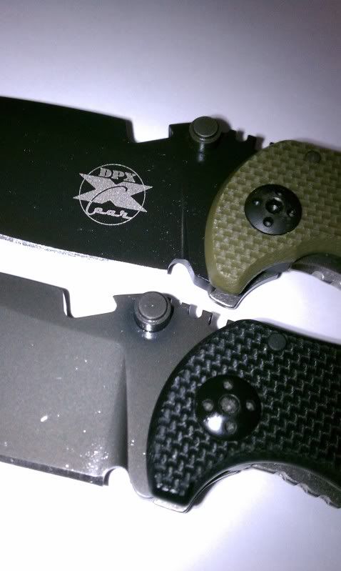

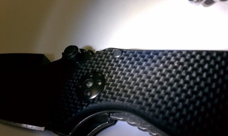

I noticed on the Hest 1.0 that the bolt which stops the blade in the opened position was not perfectly centered and would protrude on the G-10 side of the handle. On the DPx Hest V2.0, the blade stop bolt is now perfectly centered on both sides. Not only was the blade stop bolt centered but the blade also came perfectly centered out of the box as well.
V2.0
V1.0
Version 2.0 perfectly centered

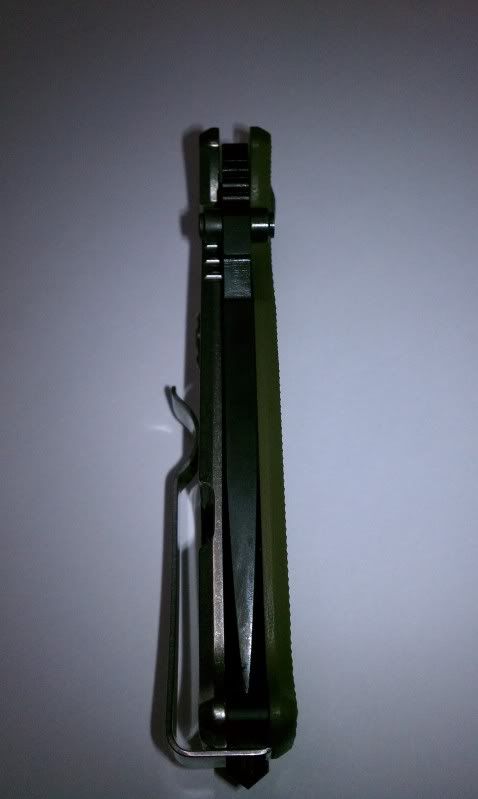

The spacer in between the handles is now also of longer length giving the knife more durability.

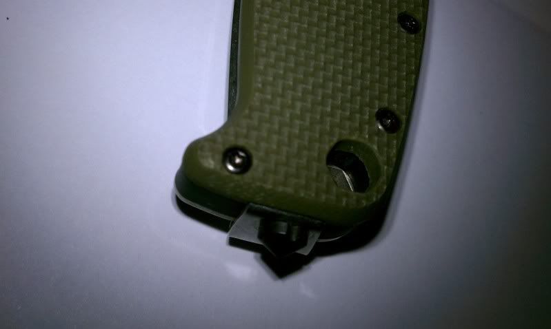

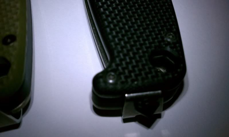

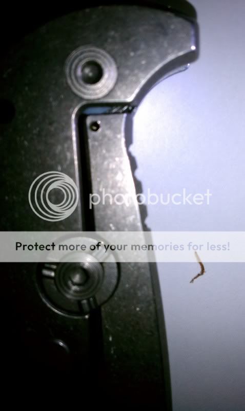

The RotoBlock which stops the frame lock from over extending has had some slight modifications for a more solid fixed blade lock.
V2.0
V1.0
V2.0
V1.0

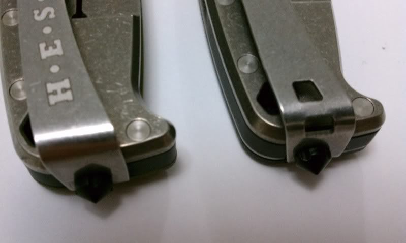

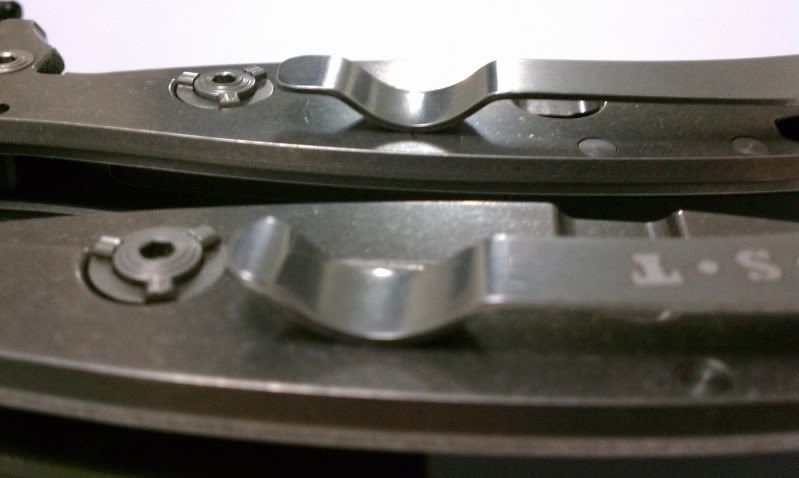

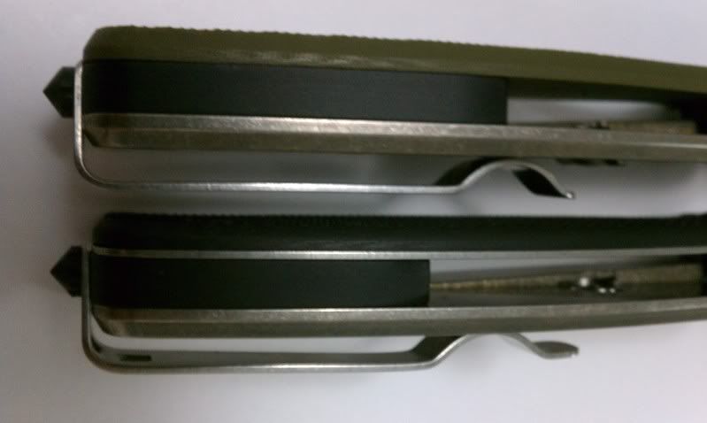

The lanyard holes drilled into the pocket clip have been removed on the HEST 2.0 to give the clip a more solid grip onto pants. I believe that the bend on the clip has been repositioned up front to give the clip a lower probability of getting caught onto objects by having a much shorter tip.
Pocket clip bend repositioning

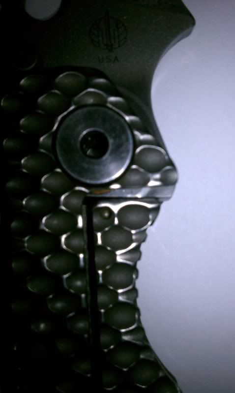

The Pivot Bolt seems to have a minor improvement as the bolt protrudes less on the titanium side of the handle.
V1.0
V2.0

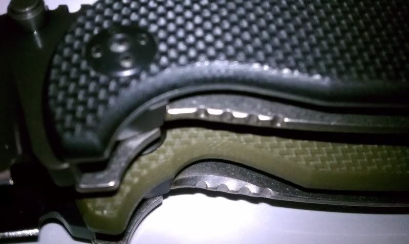

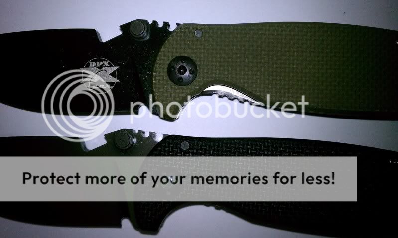

My HEST 1.0 had a portion of its edge closest to the quillon of the blade pop out in the shape of a shark fin. Version 1.0 was probably more difficult to sharpen because of the angle of the quillon on the blade. The quillon on the blade looks to be re-done and cut down to make the knife easier to sharpen.
The handle is now more comfortable and wider making the knife feel easier. The bolts connecting the handle appear to sink in just a tad bit more.
v2.0
V1.0

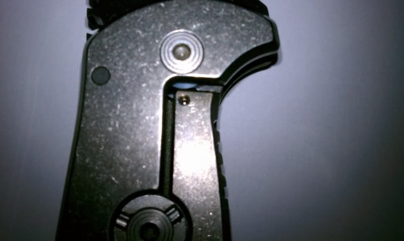

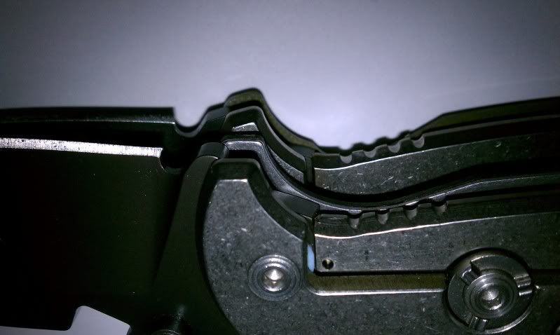

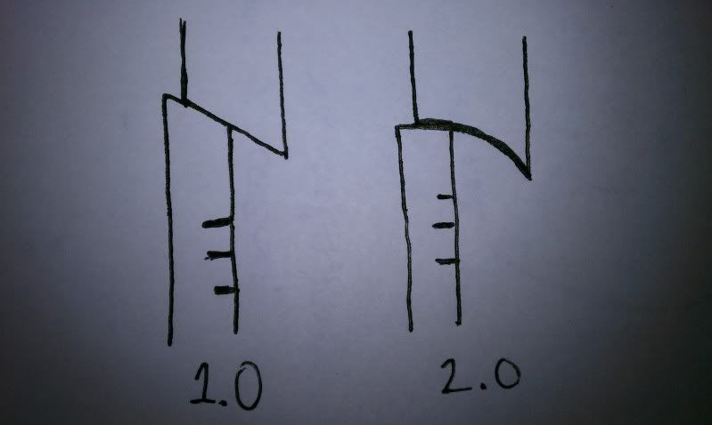

The new design on the frame lock makes the knife easier to access when unlocking with your thumb.

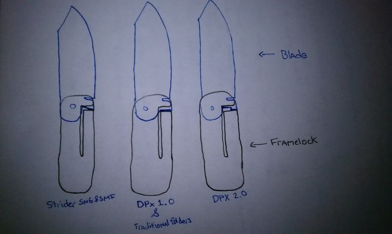

The most positive and extreme improvements I noticed on the 2.0 Hest was on the locking mechanism of the knife. I have noticed from collecting folding knives that different models of knives use different methods and angles for their frame locks. The 2.0 Hest went out of its way by using a new style of frame lock I haven't seen before. It resembles the angles I see on frame locks on SMF and SNG Striders but with its own style or method.
Below is a quick sketch to compare the different contact methods I have seen on frame locks:
Strider SNG Frame Lock
V1.0 Frame Lock
V2.0 Frame Lock
As you can see by the photos, there are major improvement to the contact points of the frame lock and blade on the HEST 2.0. I have experienced no slipping on the frame lock and the knife locks up like a tank. The ball detent ramp where the blade makes contact to the frame lock has been removed as well.

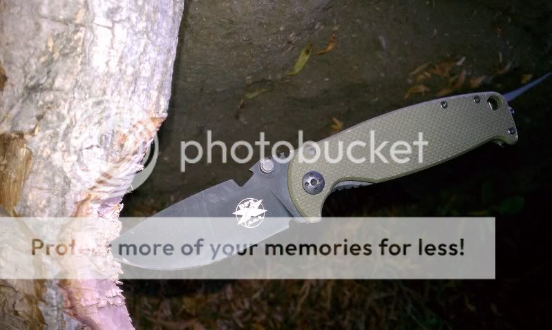

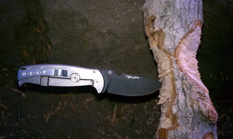

Stay tuned for the Testing Video in which I chop for 20 minutes and spine wack the knife including throwing it at a tree.
Thank you and here is the 2.0 HEST TEST:

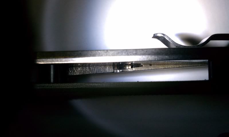

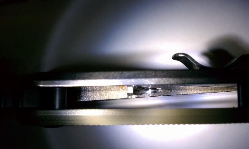

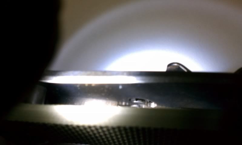

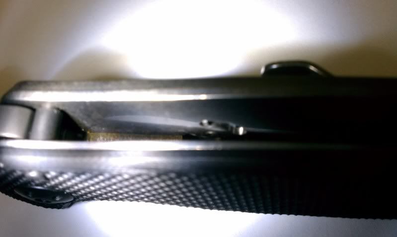

does the edge of the blade nearest the choil end still end up very close to the spine of the handle in the closed position? I cut myself pretty badly on the first run when I pressed my fingers hard on the handle.
No it does not... I can't touch the edge of the blade thru the handles (when closed) at all on my 2.0 Hest/F.

Thanks! I sold off my first production due to that issue. I will need to hunt for one of the 2.0s now :). They look to be my perfect travel folder.
