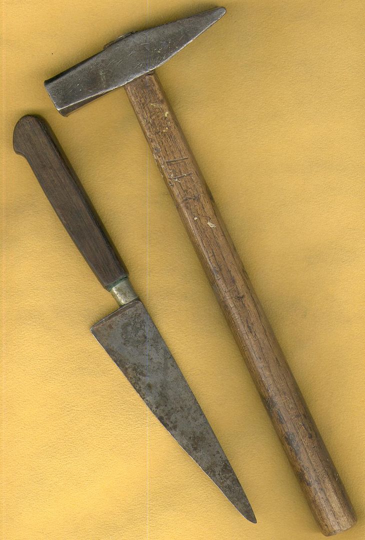

The tools of the trade!
None but the best! A fine cutler's hammer, and a venerable old remnant kitchen knife, of good quality carbon steel.
Not shown is a six inch piece of high grade 2x4, left over from building a bench in my workshop!;)
Here is where a scanner just doesn't cut it! (pun intended:D)
I'll have to describe how I got to the next step;
You open the blades of the knife, and sit it on its back on the 2x4.
If you feel uncomfortable hitting something with your hand over the upturned blades, cover the edges with a couple layers of duct tape - might save you some stitches.
No, I don't speak from experience:p!
I prefer to start the DIP tool (knife) between the main blade and center liner. Tap briskly! Watch that the tool is going straight! Bing goes the pivot pin!!
Turn the knife end for end and cut through the other pivot pin, in the same "space" alongside the center liner. Bing!!
Now continue the tool through the main spring pin, and Voile!
The knife is in two, with its innards on display!
Elapsed time - 2 minutes!!:D
Look at those beautiful rivets! Observe the slight relieving of the spring, so it works smoothly.
I've wondered if the round part of the tang contacted the spring, along with the run-up, when the blade was open - the knifemaker's secrets revealed!!
What else do you see??
