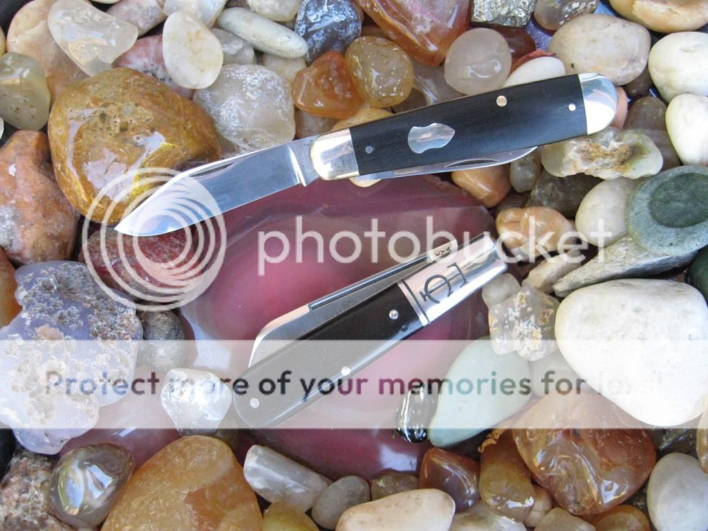

This has taken me way longer than it should have but I finally have a picture of my #15 boy's knife, modified my Evan aka Esnyx. Everything is perfectly flush and smooth. He chose some beautiful amboyna burl which is mostly a deep rich reddish brown; the unpictured side has some red swirls and it might look even better, but I like the contrast on this side. I think it goes perfectly with the brass hardware.
Please excuse any dents or dings, it wouldn't be mine if it hadn't felt asphalt once or twice:
Thank you, Evan. This knife is classy!:)

And gorgeous, too! I like the fact that combining the long bolster, making it from brass, and then using the amboyna scale material you have a one of a kind knife. As close to custom as you can get without making the knife completely from scratch.
Great work!
Robert

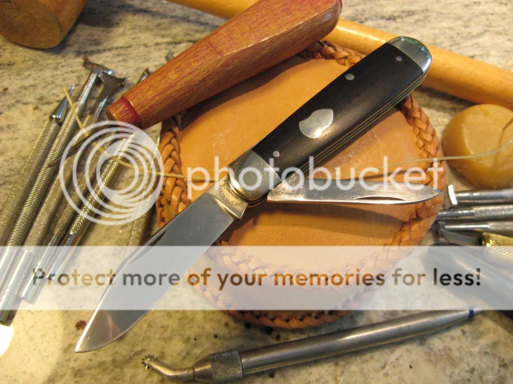

I posted this in the carry thread, but I wanted to showcase some of Evan's work here. I'm loving this knife and it will be a regular carry.

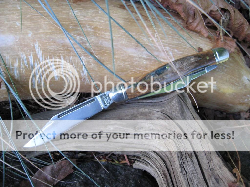

Esnyx did these two for me before he "closed the books" on mods. and I've been trying to get some good photos. The first is a Cattauragus 3 1/4 in. jack that had a missing scale and broken blade tip, now with reprofiled blade and hafted in ebony with original shield, it's a beauty of an edc:

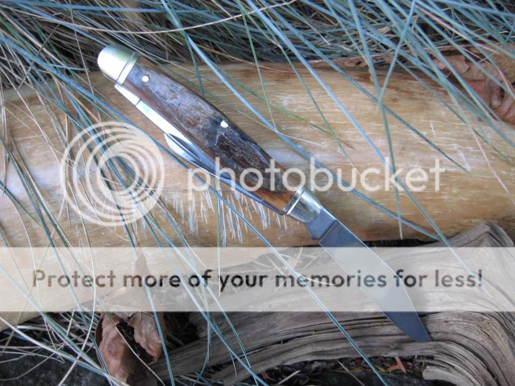

The second is a Camillus 3 7/8" stock knife that once had badly shrunken black cel scales that I tried to rebuild, but found it to be beyond my skill level. Now sporting 10,000 year old mammoth ivory. Thanks Evan! :D:D:D
Awesome work bud! :cool:
Thanks Barry! Those are some great pics!! I especially like the pic of the Cat next to the Charlow!
These were a lot of fun to work on, nothing quite like reviving an old knife!
