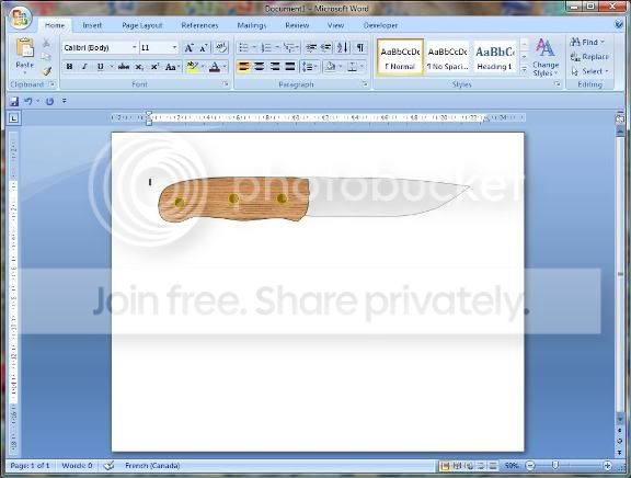

Here's some .jpg as an example:
Works OK...nothing fancy. The measurement is a little approximative, and the texturing options are pretty basic, but it works!

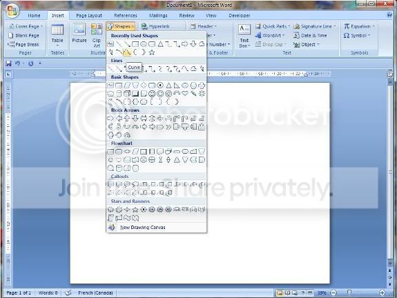

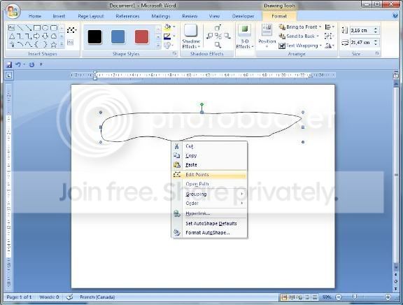

Word (and the other MSOffice suite tools, for that matter) have a pretty nifty drawing tool. In Word 2007, do "Insert", "Shapes", and then select the "Curve" item. Create a KSO (Knife Shaped Object) than right click to edit the points. Play around; most of the basic CAD functions are there :eek:
What version do you have? With the CURVE tool, you can draw anything you'd like...Here's some screen shots of a KSO I just created in 2 minutes...I took more time to upload the pictures to my photobucket account and insert the link than creating the drawing :eek:
