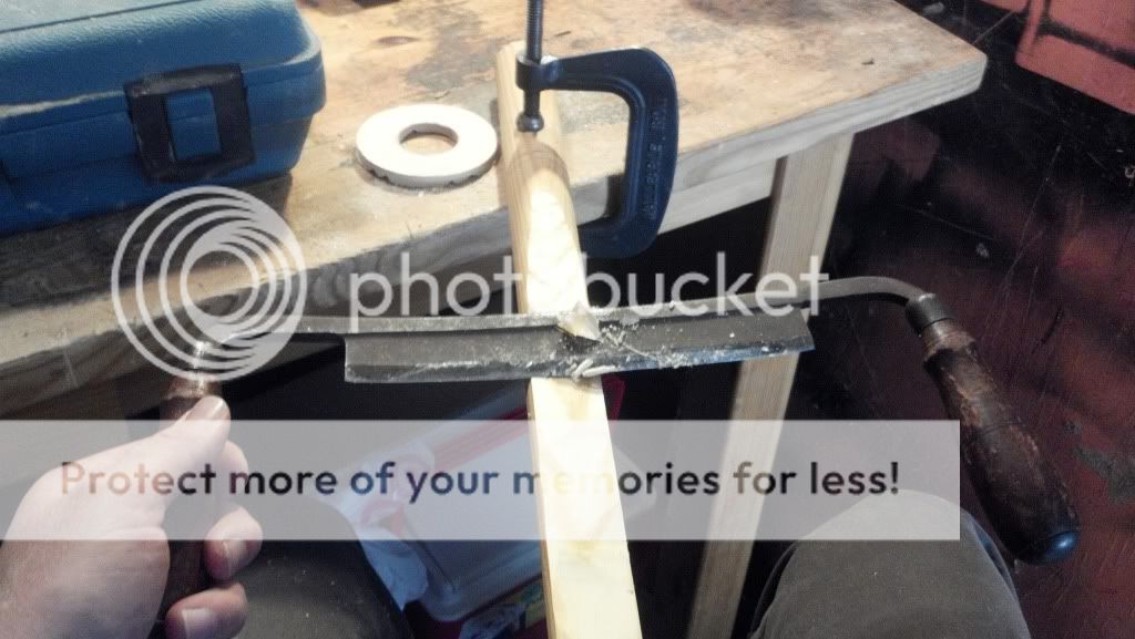

Grand dad's. Him n Dad were both blacksmiths and had THE BEST tools. Youngest daughter wanted a sword last weekend so out came the drawknife.
