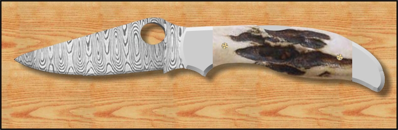

Kiwi with modified blade shape, in Devin Thomas Turkish Twist stainless damascus, wiith full flat grind. Shown with bark mammoth ivory scales.

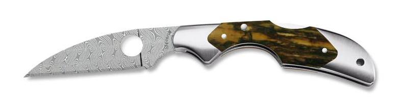

Stretch with modified blade shape, in Odin's Eye Damasteel, with full flat grind and stainless steel end bolsters. Shown with Sambar Stag scales.
