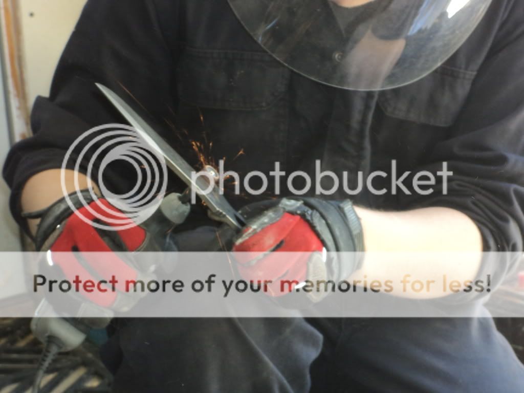

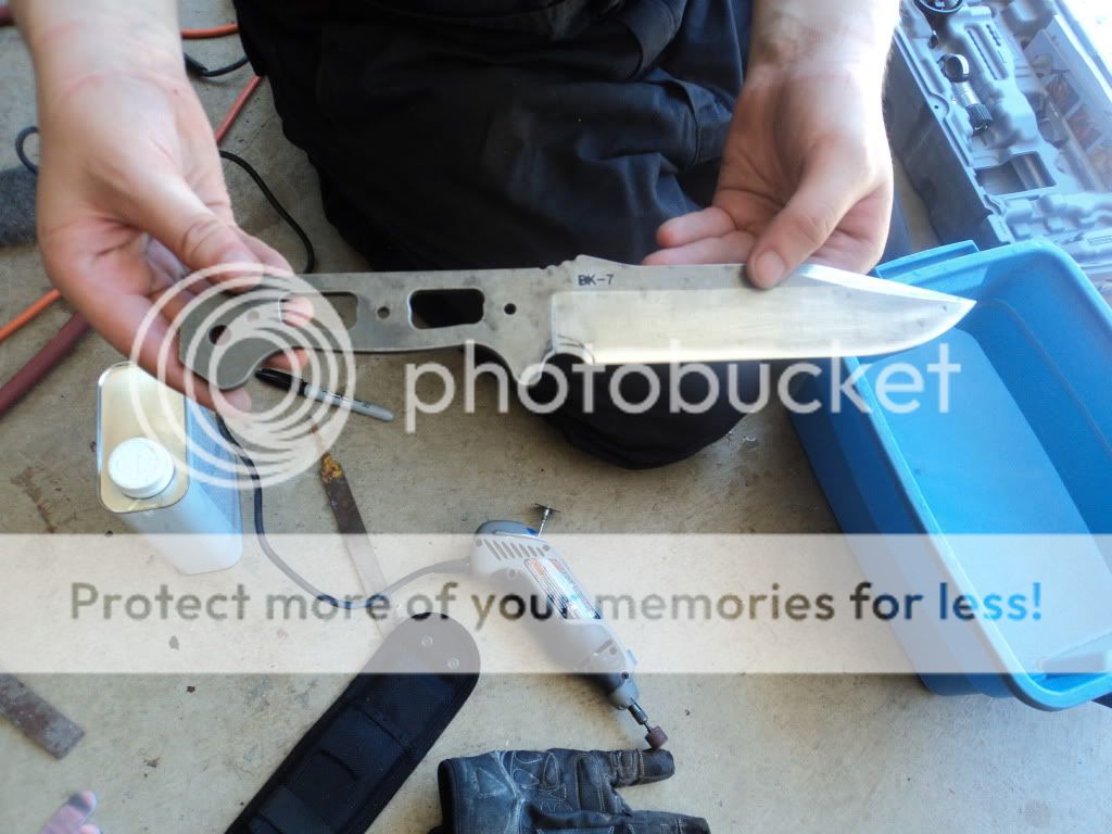

Biggest tip, plan plan plan. mark your blade with what you wish to remove or add that way there is less chance of screwing up. also get a vice, i personally dont have one and i have to freehand everything and the tool "walks" alot. below is my dremel tool, the 200, it only has 2 speeds but fits my needs well for $19. also pictured are the most use bits, cut off wheel, coarse and medium sanding drums, and the diffferent grinding wheels.
When making a choil, would you use a course sanding drum, or would you use a grinding wheel ? Why ?
I use the grinder initially since it removes so much steel fast, but once i get close to where i want the choil to be/look like i switch to the sanding drums, coarse to get the shape down, medium to smooth it out

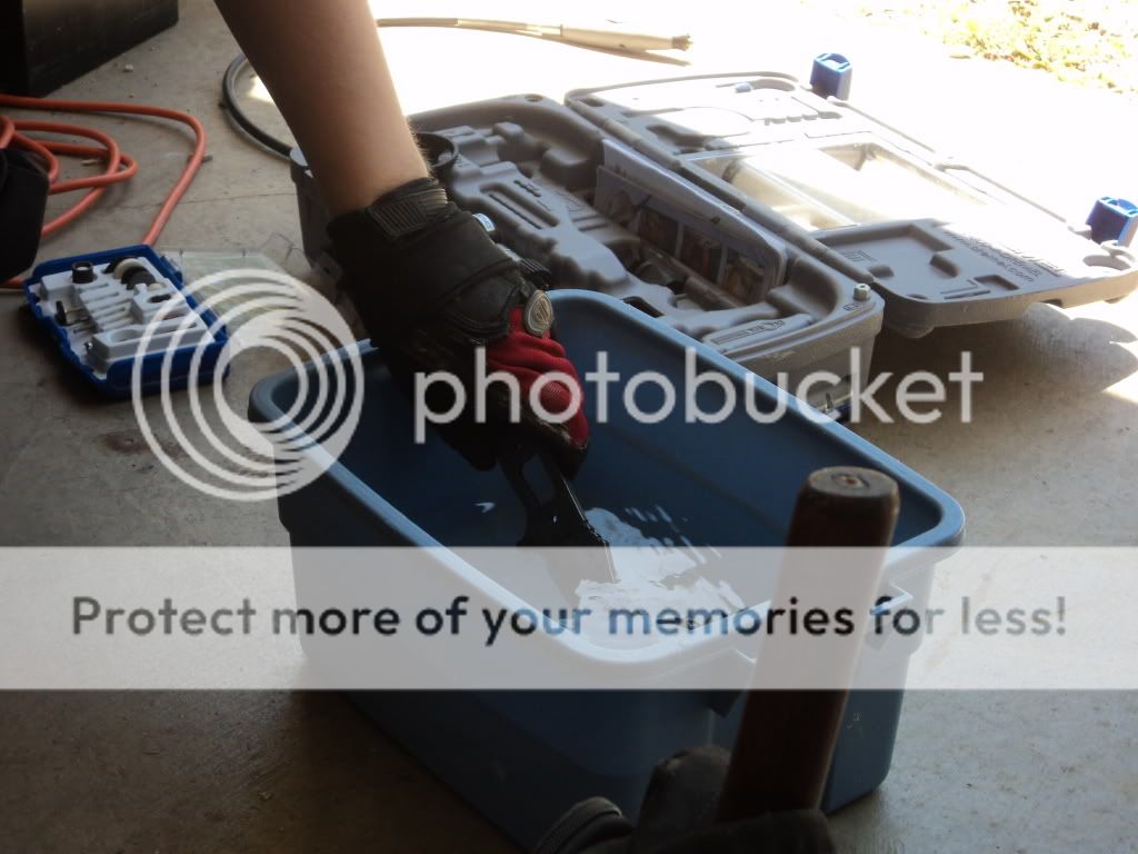

Also, when you are grinding, make sure you cool the knife down. If you let it heat up beyond what you can touch, you can alter the heat-treat.

I agree about keeping it cool, especially if you're adding a choil or doing any mods around the cutting edge to a knife that's already been heat treated..
If you see 'color tracing' on the steel while you're grinding chances are you've tampered with the HT..
go slow, keep it wet and cool, this sounds crazy but its important you feel the temperature of the knife with your bare skin. I never wear gloves when altering or making a blade so I can feel the heat that's coming from it, whether its HT'd or not..
being safe first is probably the best advise one could give.. tape the edge!!!!
WORK SLOW! Dont get impatient and hurry by turning up the speed faster than what you need.

Practice first on something your don't care about. Keep it cool enough to touch it to your lips. Take a sharpie, and black out the areas your want to remove, and hold it up to a black background, so you can see what it will look like.

Just another quick tip: It never hurts to get close with a power tool, but put the finishing touches on by hand with something like a file to get that added precision. Just because you have the dremel, don't discount a good file.
