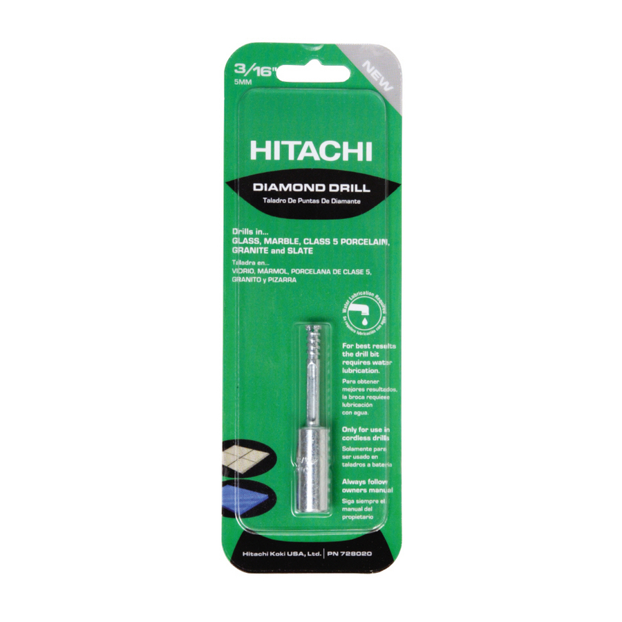

Just to add to Nathan's advice, Never use carbide on annealed or mild steel, it's to gummy and will break the carbide right off, also you can get Diamond Dust Drills for about $20.00 a pop at your local Lowes Hardware Store might be a less expensive route in the long run.
