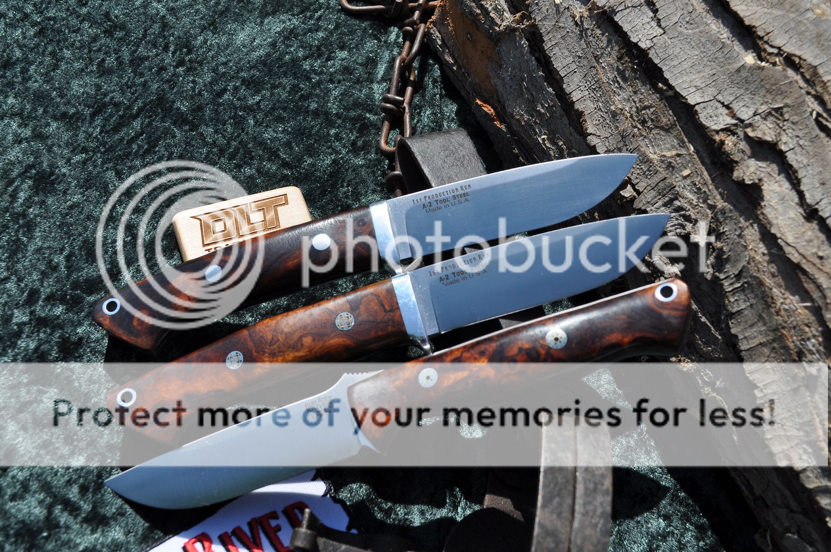

Great info from Pinnah. If you are dead set on carbon steel then your options start to get limited as most of the major manufacturers tend to favor some type of stainless in a drop point hunter.
You could check out Bark River or Winkler. Both are highly respected with a strong following and both use carbon steel (A2 in the Bark River and 5160 in the Winkler) in their fixed blade hunters. They definitely aren't cheap though...
Good luck with your search!
