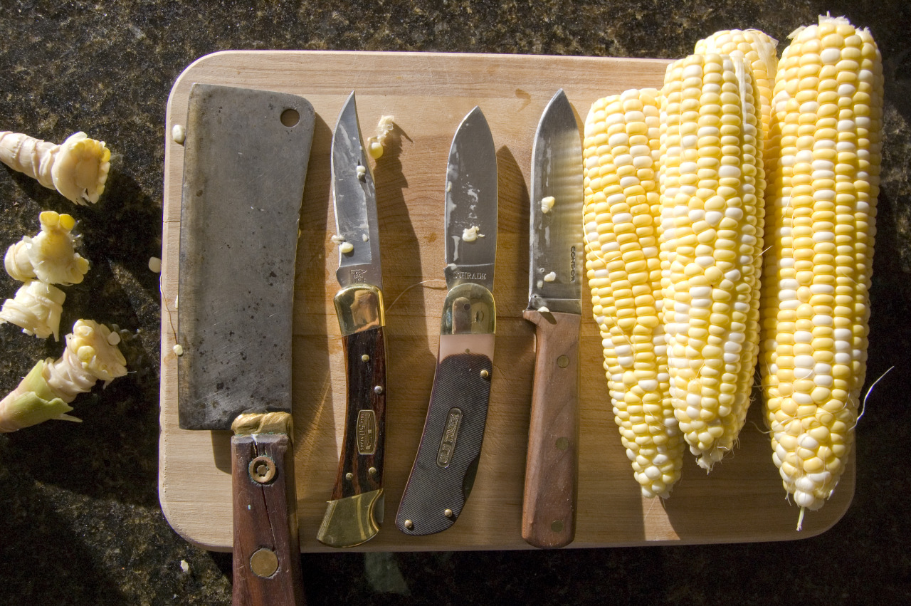

Condor Kephart runs about twice the price of the Mora Companion, but it's more traditional in appearance and has a flat grind. Handles well.
On the bottom in this photo:
At right in this one:
(This was a bake-off, testing blades on corn for dinner. It turned out that a new factory edge on the Buck 110 cut better than the cleaver, the China-Schrade 51OT, or the Condor — but the also-rans were all quite good. (Need to learn better sharpening.)

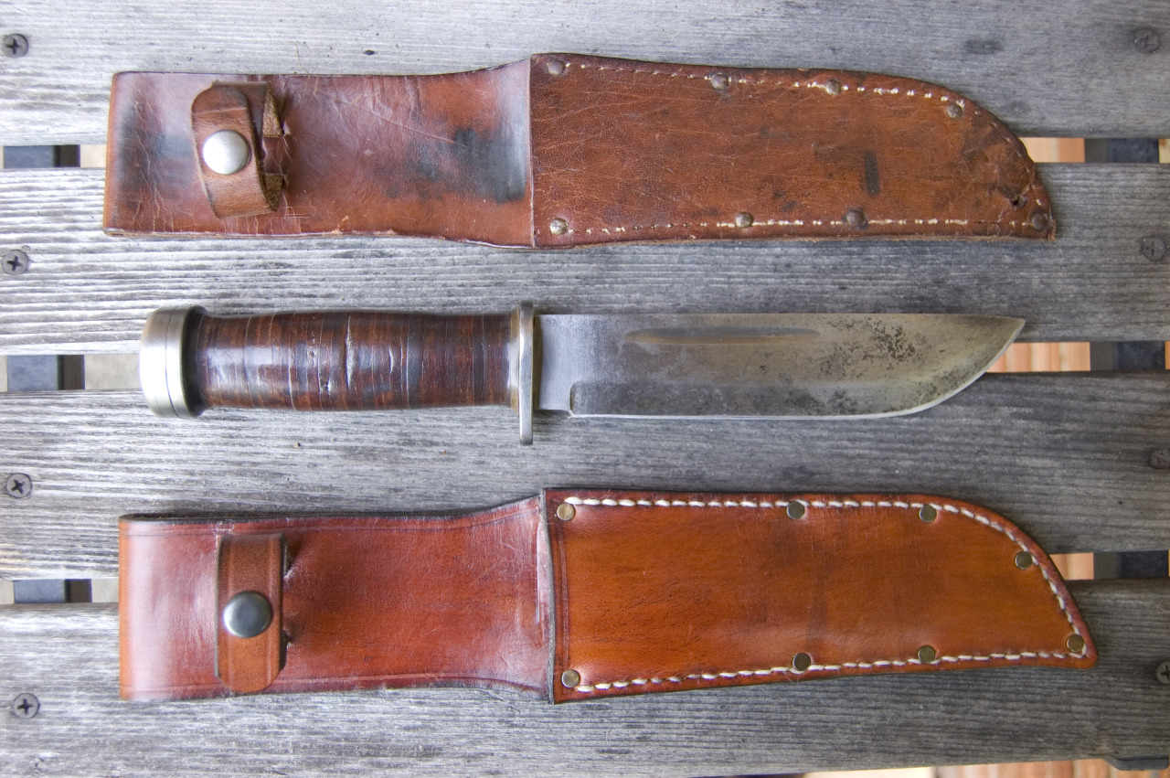

And for corn tonight, I used this Cattaraugus 225Q (original sheath on top, replica by Harry Savage at bottom).
Ker-THUNKKK! No problems whatever.

The sheath is exactly what I wanted. The knife is in outstanding condition, but the sheath is a 70+ year old veteran that's earned its rest. Because the original sheath as a bit thin in my view (although obviously it survived all that both it and the knife have gone through), I asked him if he could reproduce the 225Q pattern sheath, but to make it out of slightly thicker leather. Which he did, and it's excellent.
