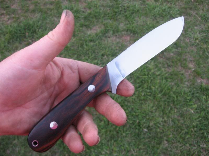

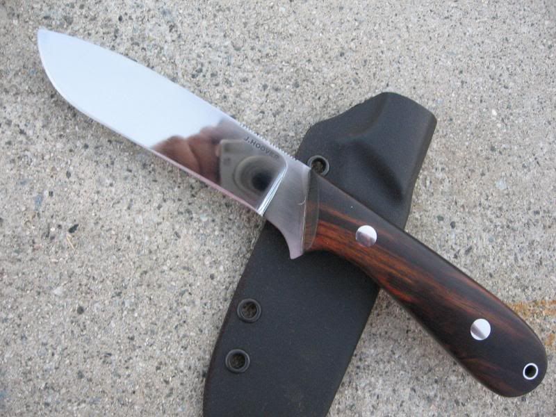

I made this one for hunters, it's designed for skinning. Lot's of belly out on the front and room to choke up on the blade for control when required. Here are the specs:
Steel- A2 Tool Steel X 5/32
Blade design- Drop Point skinning knife
HT- Done in house with 3 two hour temper cycles
AOL- 9 1/2 inches
Grind- Flat
Blade- 5 inches to front of scales, serrations on spine
Handle- 4 1/2 inches
Scales- Desert Ironwood
Hardware- Stainless 5/16 Corby Rivets and 1/4 inch lanyard tube

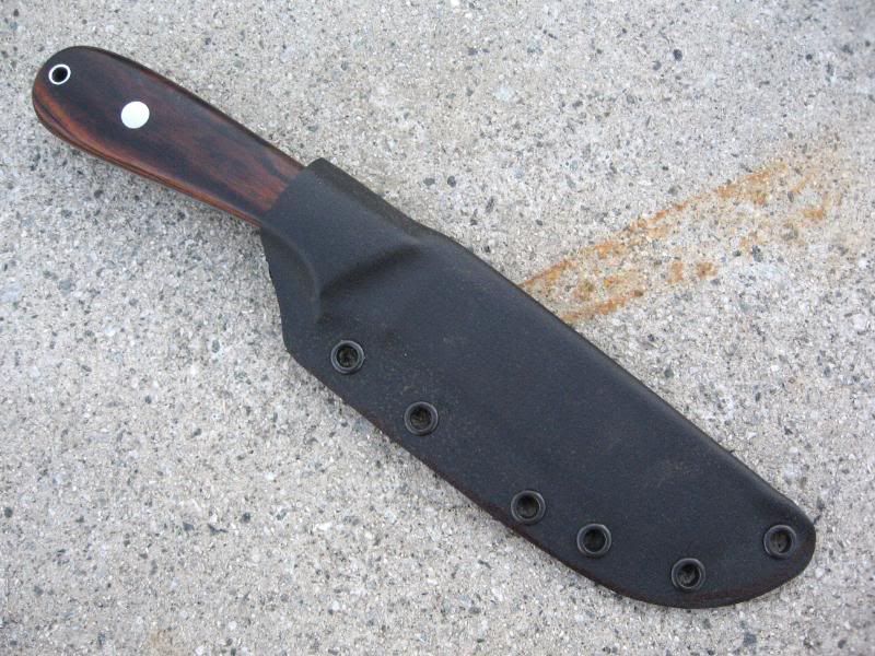

Kydex sheath set up for large tek-loc, works for right or left hand carry, horizontal or vertical. ( Tek-loc not included)
Asking 150.00 shipped in the USA and Canada.
Paypal or USPS M/O preferred
jvw336@wildblue.net
Comments, questions or critiques welcome
Thanks for looking
