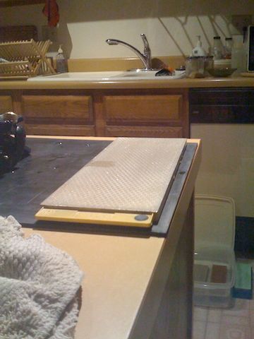

Nah . . . use a killer coarse stone like 120 or a diamond extra coarse (which is actually less coarse) at 200 and
lets geeeeterdone
in like ten or twenty strokes then a few strokes on progressively finer stones to "hone" in on that shave sharp edge.
There is no wonder the poor guy is falling asleep at the wheel if he is in the zillions of strokes mode.

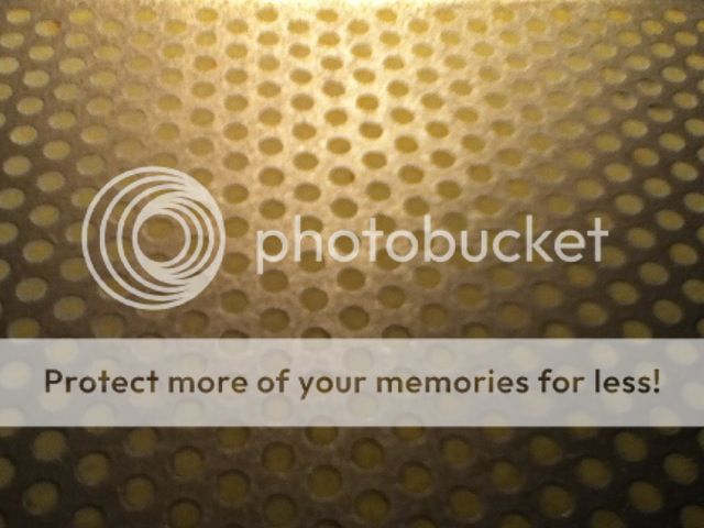

The DMT diamond plate with the black dot is the coarsest or there abouts
OK so I like taking bad photos of my diamond plate
Or better yet get an Edge Pro with a coarse stone and . . .
reeeeeeeeelaaaaaaaaaax
What the heck here's one more link

Smith Sharpening system, and also a Smith for field (coarse/fine)
These are diamonds, I don't have rods.
