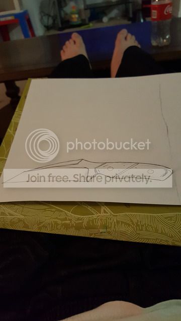

I'm sure this is probably a really dumb question but is it possible to use the scrap steel from say AEBL for bolsters? Why or why not? If so should I keep it annealed or fit up the bolted then send off for heat treat. I know forge guys do an integral bolster it's kinda the same concept but with stock removal. Thanks in advance
Justin Schmidt
I just fitted a piece of cpm154 for a guard on a knife this afternoon. Not sure if it's thick enough for bolsters but definitely a thin guard. Leave it annealed.
Dang thickness was something I wasn't considering. I got .138 AEBL. wonder if I could stack it up probably not though
Good point. Well if I make a 7in knife instead of 7.5 or 8in OAL I'll have about 4.5in to work with so maybe a small pukko (Sp?) But I like the idea of small neckers.

I actually just commentedon that little tanto asking about the OAL lol very inspiring stuff. I actually have a knife drawing that inspired by a wharnie you did
