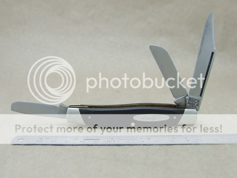

Example - Early 70's Cami contract.
Good toothpaste and toothbrush cleaning and mineral oil soak for 5 days.
