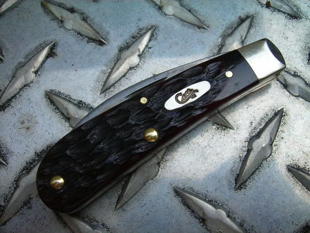

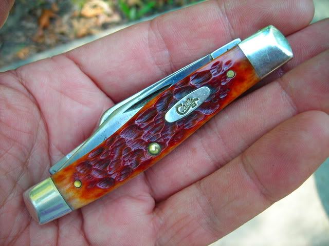

For this article, I dyed a Colt congress in stag bone.
It's a VERY nice knife, I love the congress pattern anyway, and this is a superb example.
Nice thick heavily jigged bone scales, perfect fit and finish, half stops on all blades, and beautiful long pulls and swedges. All for the princely sum of $15!
The only thing I don't really like about this knife is the color of the scales, but we can fix that
I actually bought this knife with the express intention of dyeing it.
So, without further ado, let's get busy dyeing!

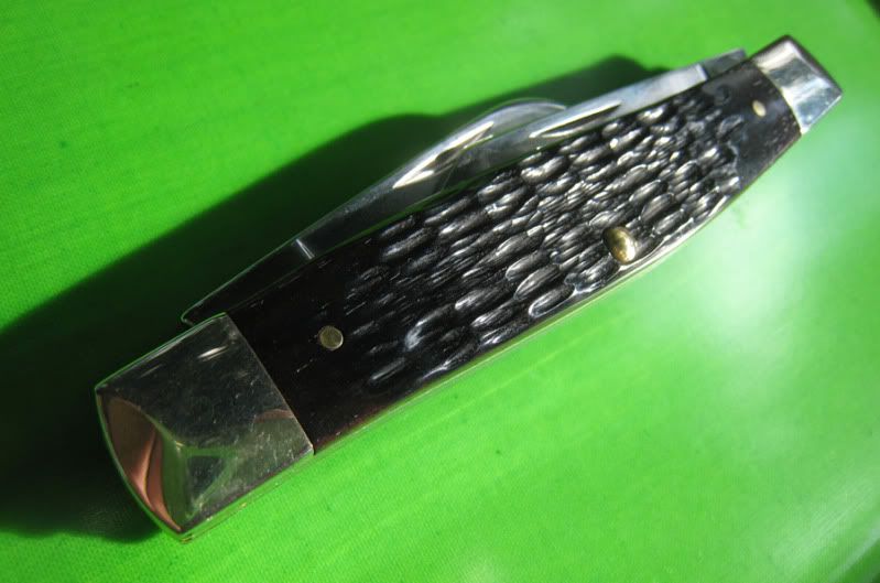

Like an idiot, I forgot to take a 'before' photo, so I borrowed one from the internet.

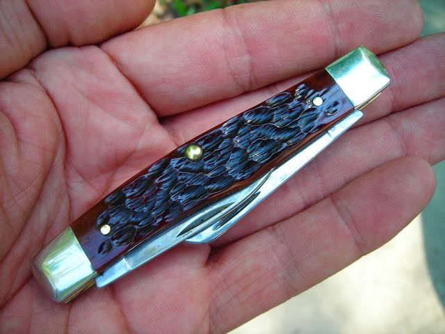

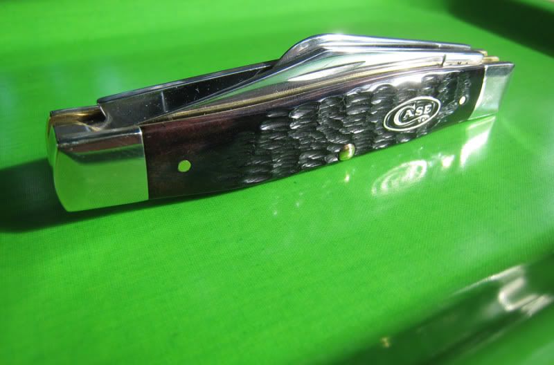

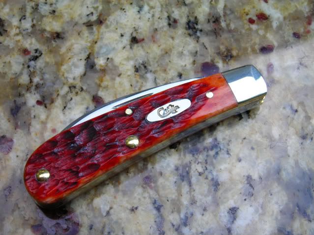

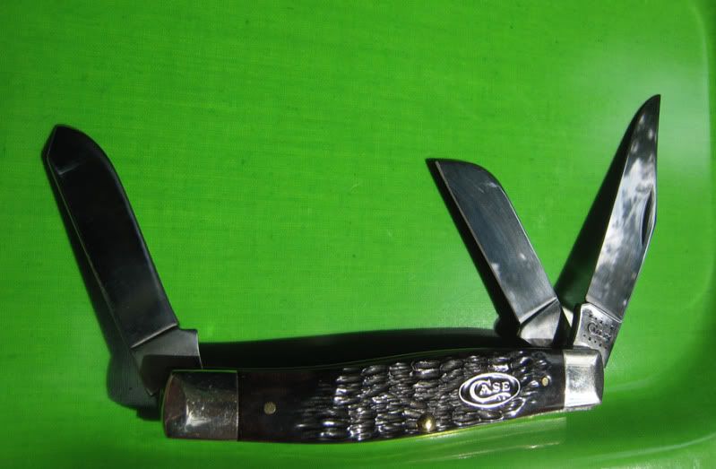

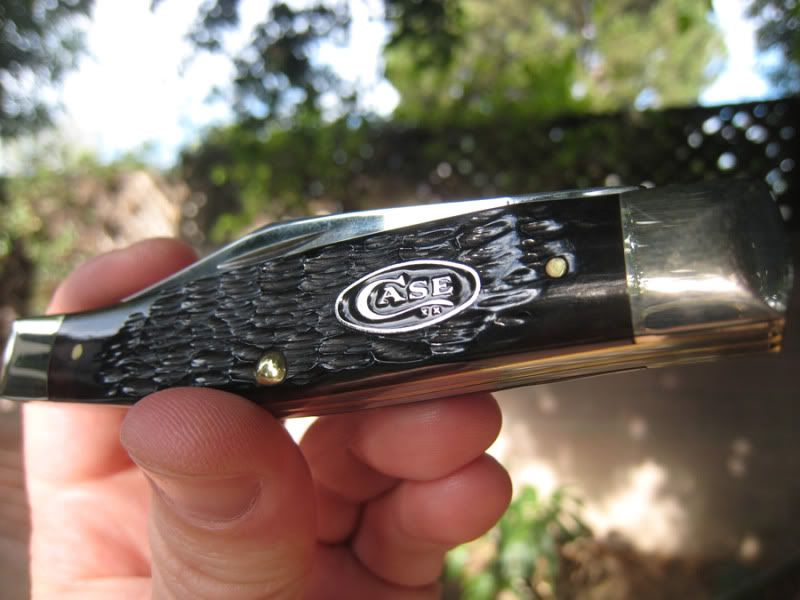

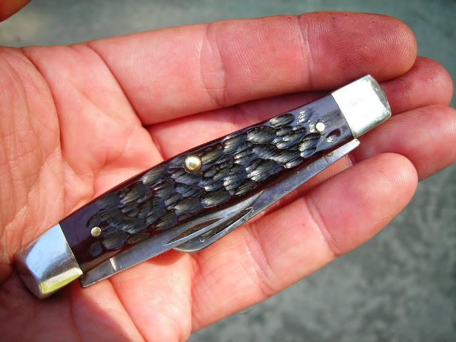

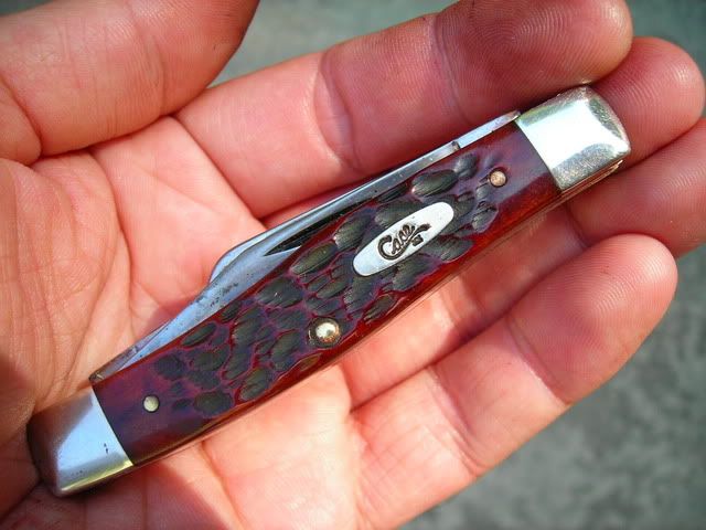

After fifteen minutes or so, turn off the heat and allow the pan and it's contents to cool naturally.
When the contents of the pan are reasonably cool, remove the knife with tongs and place it on a paper towel to finish cooling.
Flush the knife thoroughly with water to get rid of excess dye.
Carefully open all of the blades and use Q-tips to get into all the nooks and crannies.
Dry the knife thoroughly.
At this point, I suggest a good oil bath to condition the surface of the bone, and also to protect the metal.
I saturated my knife in mineral oil and let it sit for half an hour.
Give the knife a good rub down with a paper towel to get rid of the excess oil and dye.
Admire your 'new' knife
