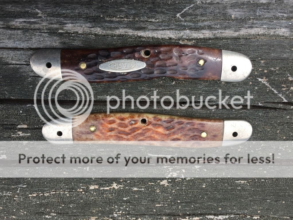

I thought I would bump this thread up again as I am about to undergo this process as well. I've got an old case medium stockman with bone scales and broken blades that I'm going to to transplant to a newer knife with yellow scales and good blades. The bone is nicely pocket worn but the colors are badly mismatched. I don't know if it was originally like that or if one side was exposed to sunlight but either way this is a perfect opportunity to try the Rit dye experiment. Here is the before pic and I will update when I get done with the dying.
So here it is after dying

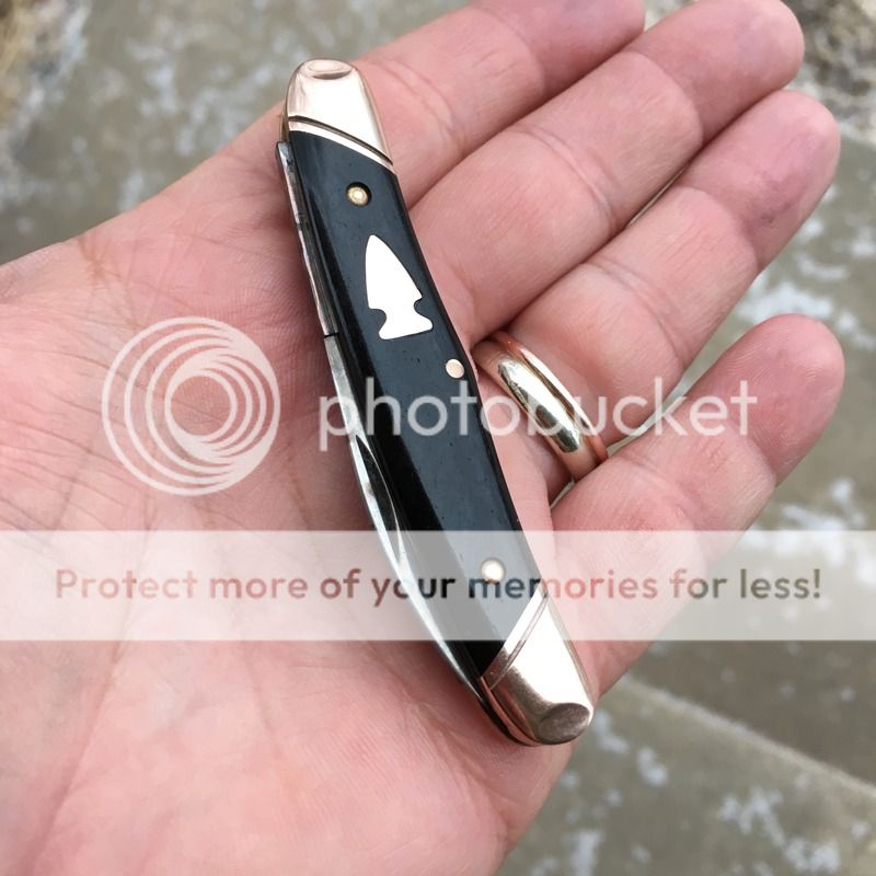

And here it is all put together. The dye didn't hold as well as I hoped so I've got it running another course in the bath right now.
Brilliant job guys! Some really nice transformations. It's shocking how bad some of the "before" pictures were.
You really have to wonder what they were thinking. What an improvement!
Very nice Jollytime...the black came out nice and even! Although the original blue green was not that shabby a color.
It wasn't bad but I really didn't dig it. If I kept it that way I would have ended up selling it and I really wanted to keep it.
