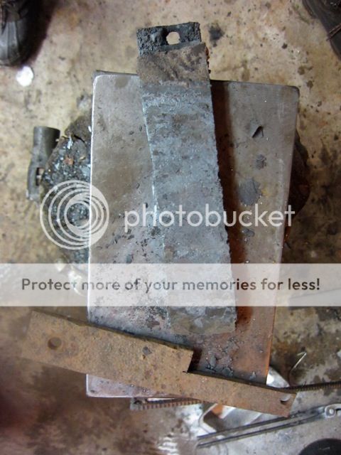

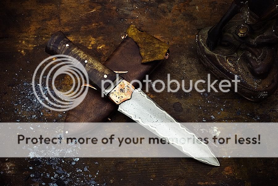

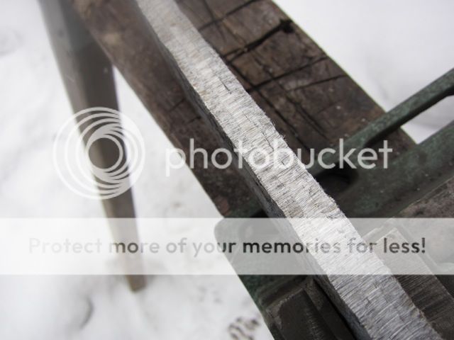

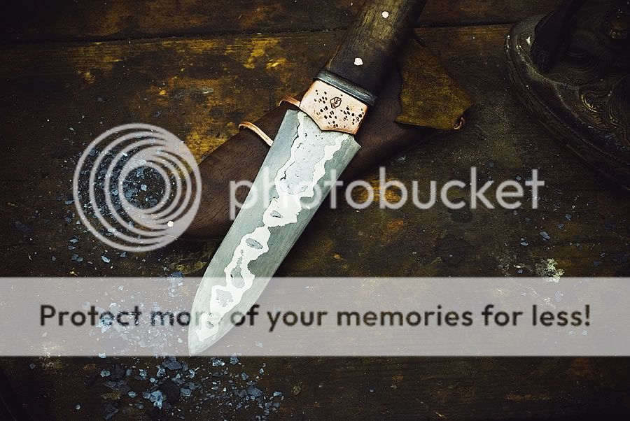

This one was made for Mark Farley and it was forged from wrought iron, pure nickel and 1080. I'm going to start off by saying that I made a big mistake on this which was almost fatal to the project. I tried to fuller in a blood channel down the middle with my mill and the piece jumped creating a devastating gash that practically had me in tears. The only option was to grind down below it.. which left me a dagger with two personalities. A side displaying what I originally had in mind... a lot of wrought, a nickel layer and a thin cutting edge. The obverse side ended up being... different. It became all about nickel/wrought iron islands floating in a sea of 1080. I'm not unhappy with it in retrospect. Although lack of symmetry sometimes gets me down.

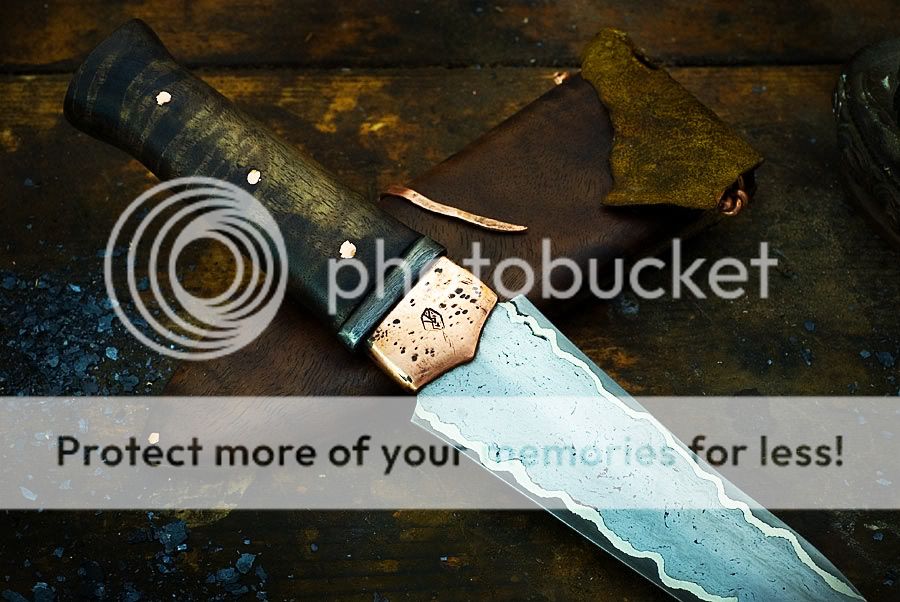

It is overall 10" and dressed in a cold forged copper habaki with a wrought iron bench to sit on. The wood is Claro walnut.
The scabbard is something I had fun with. I wanted to have something more 'saya-like' since habakis are designed for fitting into one. So I morticed some wood and glued veg-tanned leather onto the back and brain-tanned doeskin as a liner. Twisted copper wire, a pin and some hammered copper wire wrap hold it together in case of glue failure. It is designed to slip into your calf-high leather boot.. or maybe your hi-top Chuck Taylor? I'm quite pleased with it and plan to make more of these things.
