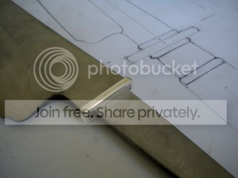

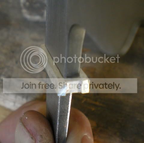

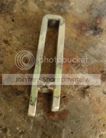

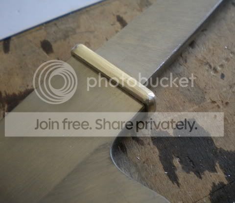

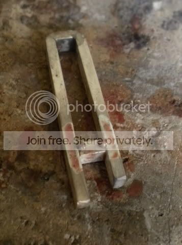

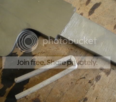

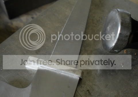

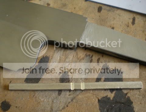

An easy way to dress up a blade and make a nice transition into the guard in under an hour.
Notch
Bend
Solder
Check fit
Solder end in
Trim
File and clean up
Not bad for an old Geezer....... The body maybe going downhill but the mind is as sharp as ever.........
Pretty neat. Is that brass? Do you solder it to the knife also?
It's silver.
It'll be a good fiction fit with some JB Weld to seal it all up… like the guard. The small shoulders on the blade and the guard will lock it in place.
It's just a simplified version of this one without the inner sheet piece.

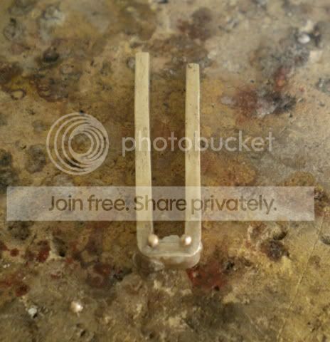

I get it, nice and simple and looks great, but what are the small pins for? You filed them off, so I'm a little lost.
Dave
Dave
I think you mean the silver solder granules. I like using solder spheres on certain types of seams. They're easier to control on some stuff, than wire or sheet pieces. I solder with those granules a lot.
All I do is put some flux on a tiny piece of solder and heat it with a torch. When it melts it pulls up into a sphere.
