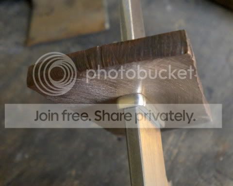

Easy blade collar fabrication

It's high temperature silver solder. I used a Mapp gas torch.
You can play with the patina etc., to get a good color match if you think it’s necessary.

I like fabrication because it’s fast and direct. It also tends to be more durable than cast, because of milling, work hardening etc. However, I usually expect to see some very faint solder seams, which don’t really bother me as long as the seams are clean and tight.
...The placement of the seams is also a factor to consider. I try to plan it out so that the seams are in areas that are the least noticeable or distracting.
One last thing on the seams,… High temperature silver solder comes in 3 grades, low, medium and high. The high (sometimes called hard grade) is the most pure with the least alloy content, so it shows the least. A good tight fit with high grade is nearly invisible. That’s what I used on the collar.
You bet Nick!

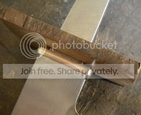

Here's a couple shots that show how it'll fit up with the bronze gaurd and lock the collar in place.
