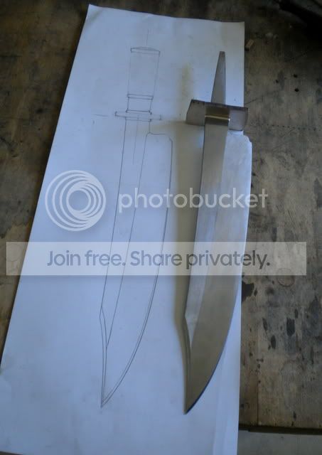

Here's sort of where I'm going with it, basically, but it'll have a semi octagonal wood handle wrapped with Turks head knots and capped off with metal on the ends. I'm not a good enough drawer to draw that.
Still a very good drawing, I couldn't draw that.. That's gonna be a really nice knife when you're done! Thanks for sharing your techniques
Thanks.
I had an idea of what I was going to do, (it's for someone), then forged the blade. Once I had the blade, I used it as a template for the drawings and just fiddled with the proportions until it sort of balanced out.
I may still tweak it a little.

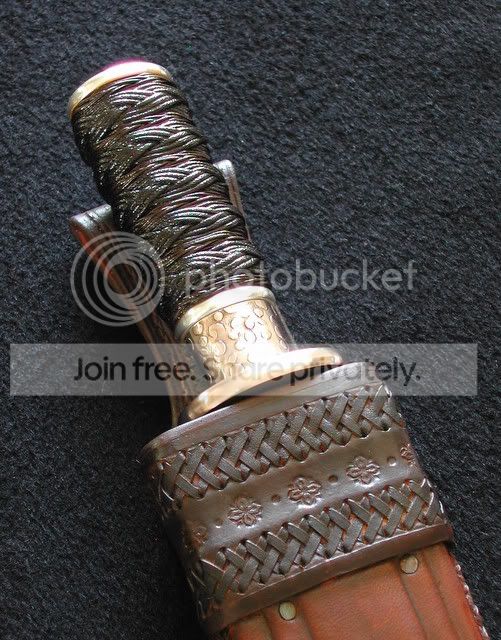

It's styled after this one. I wish the semi octagonal cross section showed better in the pic. It's a subtle detail, but I really liked how it worked out geometrically with the knotting on this one.
It's also an order, so the wrappings are part of the deal.
The ferrule and end cap, (handle fittings) will also fit over the wood to hold it all together on the ends. I might change the texture on the ferrule a bit, not sure yet. All fabricated non ferrous smith work... cut, bent, forged, brazed etc.
